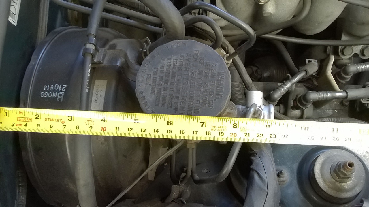

Be aware that some of these cars have a larger servo with an awkward shape to fit the standard engine brace.
Not sure what the servo is like on the auto but I have found the 1.6 facelift model can be a problem.
There is a mod to get the brace to fit but a while since I got involved. A google search should see you right if this is your issue.

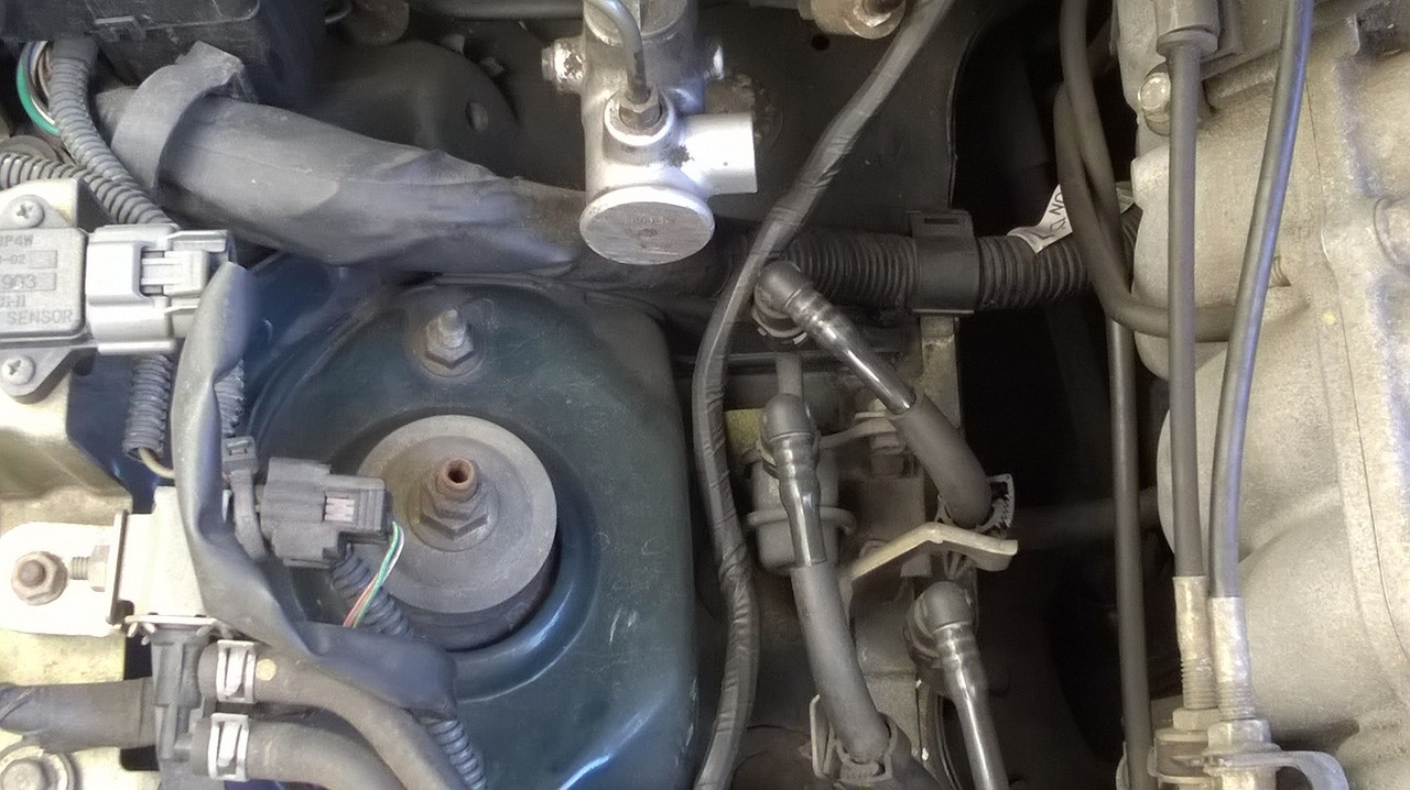

Can you post a piccy of the servo and I’ll have a look at mine to compare?

Rhino is correct and this is where my problems started. The brake servo on my car is longer measured from bulk head to end and is why the MXparts latest IL tower brace with servo stop will not fit. Did ask if servo stop was removable but they didn’t know.

I asked you to pop in a picture to enable me and others to try and assist with at least an A/B visual comparision.
That IL, to my eyes, seems a lot fatter in the securing plate dept…not to mention you do not have to worry with an OEM one regarding servo brace.

My problem started when I tried to order the IL bar from MXparts who advised me about clearance of the servo stop. I checked and mine extends 245mm and realised not all servos are the same size. Then I asked them if I could remove the stop, or shorten the screw and got a very cold “no idea mate”…

Pics as requested at last!
