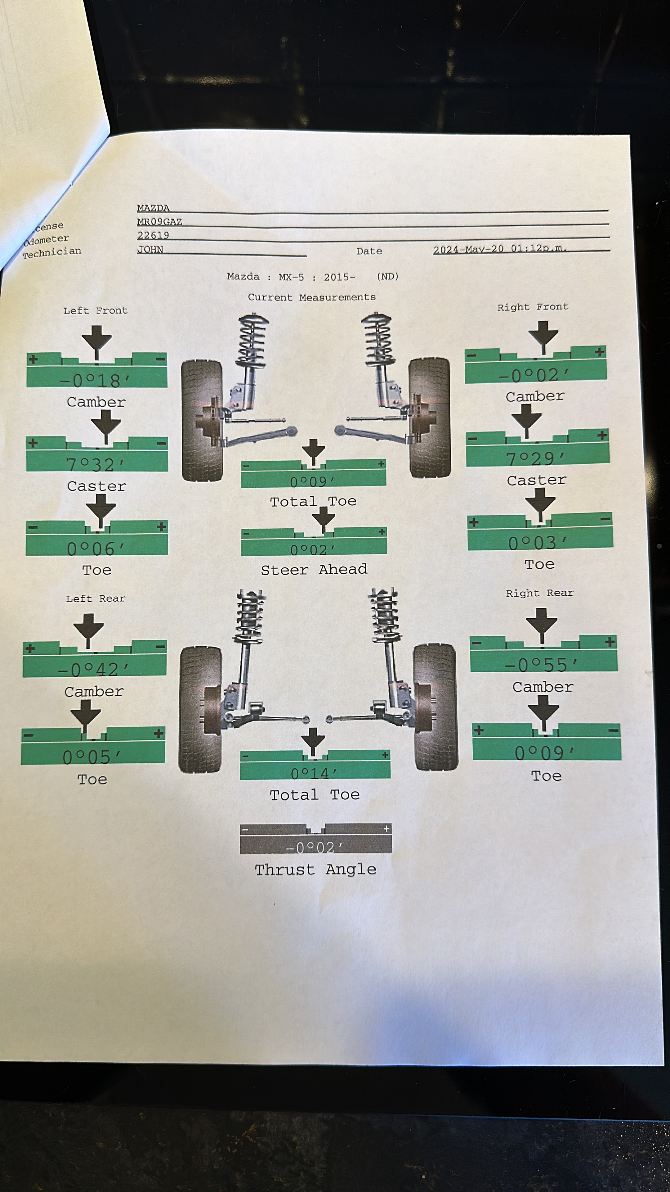

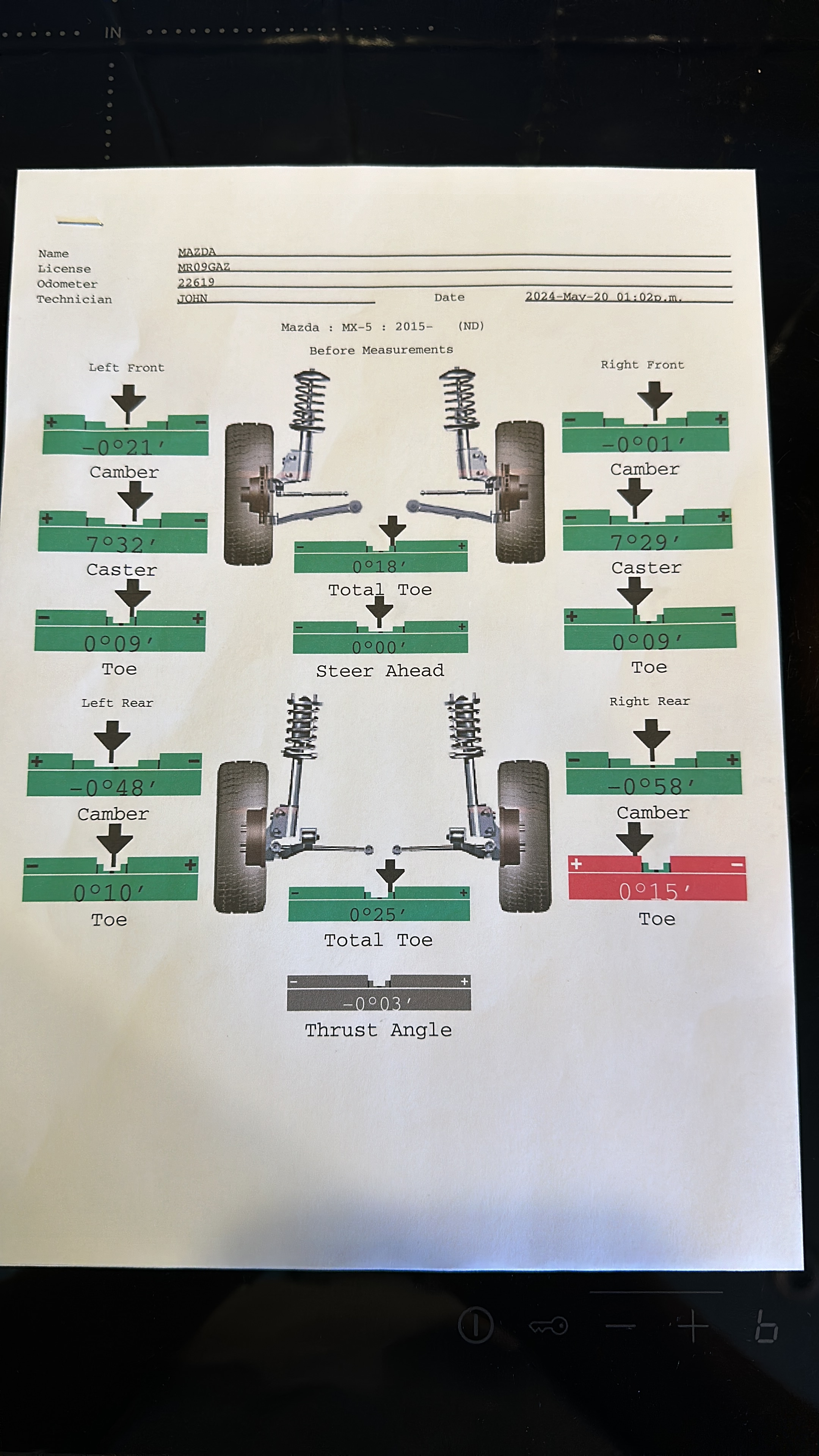

Before and after… streering wheel is now central too.
Maybe I’ve not been aware of the steering wheel not being exactly central, but thinking it was when I was forced onto the soft verge when someone pulled out in front of me on the A90. The kerb was thankfully one of those angled ones, so more like a solid ramp. Car definitely feels better now. :+1:t2:
