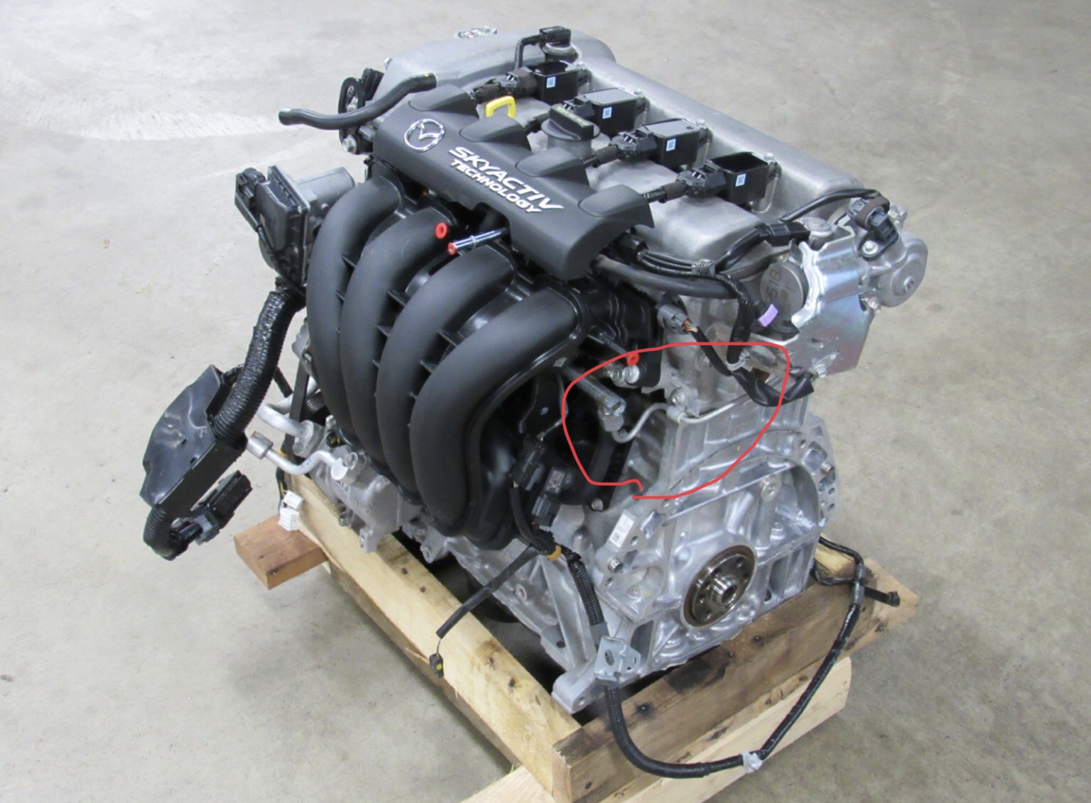

The affected fuel pipe runs across the back of the engine under the scuttle panel.
Visible in the area circled.
