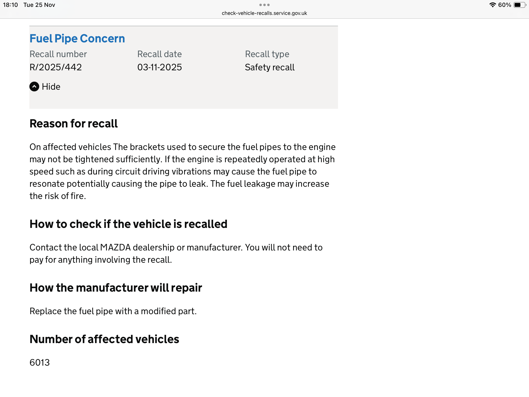

A recent recall I hadn’t seen mentioned, in other countries there is talk that replacement parts will not be available until next year. Owners of affected cars will be notified through official channels in due course.

I think Ian’s opening post which shows the recall, is from the gov.uk site though?

Reading the first post, they mention there isn’t any cost to pay for the car owner.

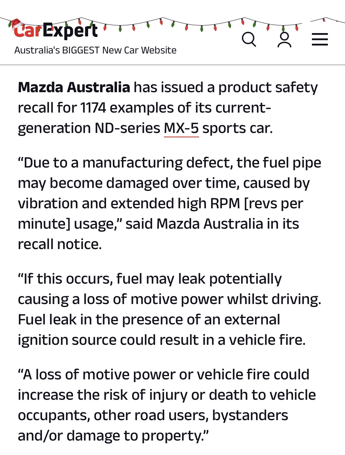

The Australian press talks about “loss of power” and/or “fire risk”. On balance seems to be extra cautious
