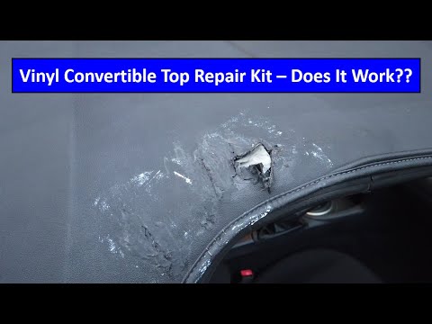

You can buy soft top repair patch kits
I have patched hood with glued on vinyl patches on both sides of a tear; they looked ugly but did the job.
For small holes
Larger
Longevity depends on prep.
