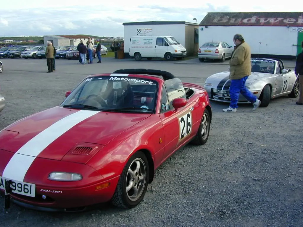

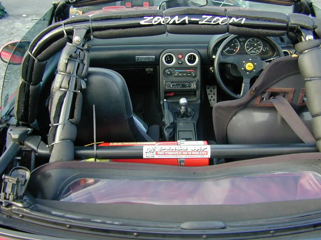

What modifications you can do depends on the rules of the competition entered, and which class you ut yourself in.
When I did it, I just ut in a rollbar and a seat, but I was running in a production class. The car wasn’t particularly competitive, not a lot I could do about that, and I wasn’t into pushing the patience of the scrutineers, like the boys in the Novas and Minis would, who generally ruled by class.
I fitted a 6-point harness directly to the car, rear shelf, with spreader plates.
I think depending on the rules, fitting 13" wheels, and taking off the front disc dust shields, would give a gearing advantage on hillclimbs.
Do you remember where you got that gear knob??
Still have it, its an original Bob Krueger Team Voodoo Magnum knob, still available:
