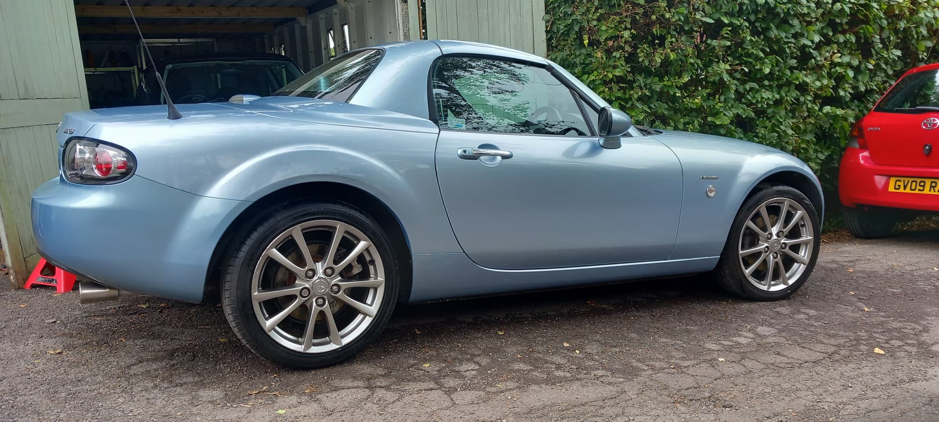

  3. I’m looking for technical help or recommendations on wheel paint code. I am looking to get my alloy wheels repainted, but I haven’t had any luck finding a paint code, so I would be grateful for any help

The alloys on the Niseko Edition are Shadow Chrome , which has a base coat colour of Black & then has 5 coats of Silver applied on top before finishing with the clear coat lacquer.
I have just had a set totally refurbished & that was the exact procedure used & they are perfect.
One wheel was stripped initially & refurbished using the other wheel as the colour match ,it’s quite a longer process due to the slightly extra work involved.
