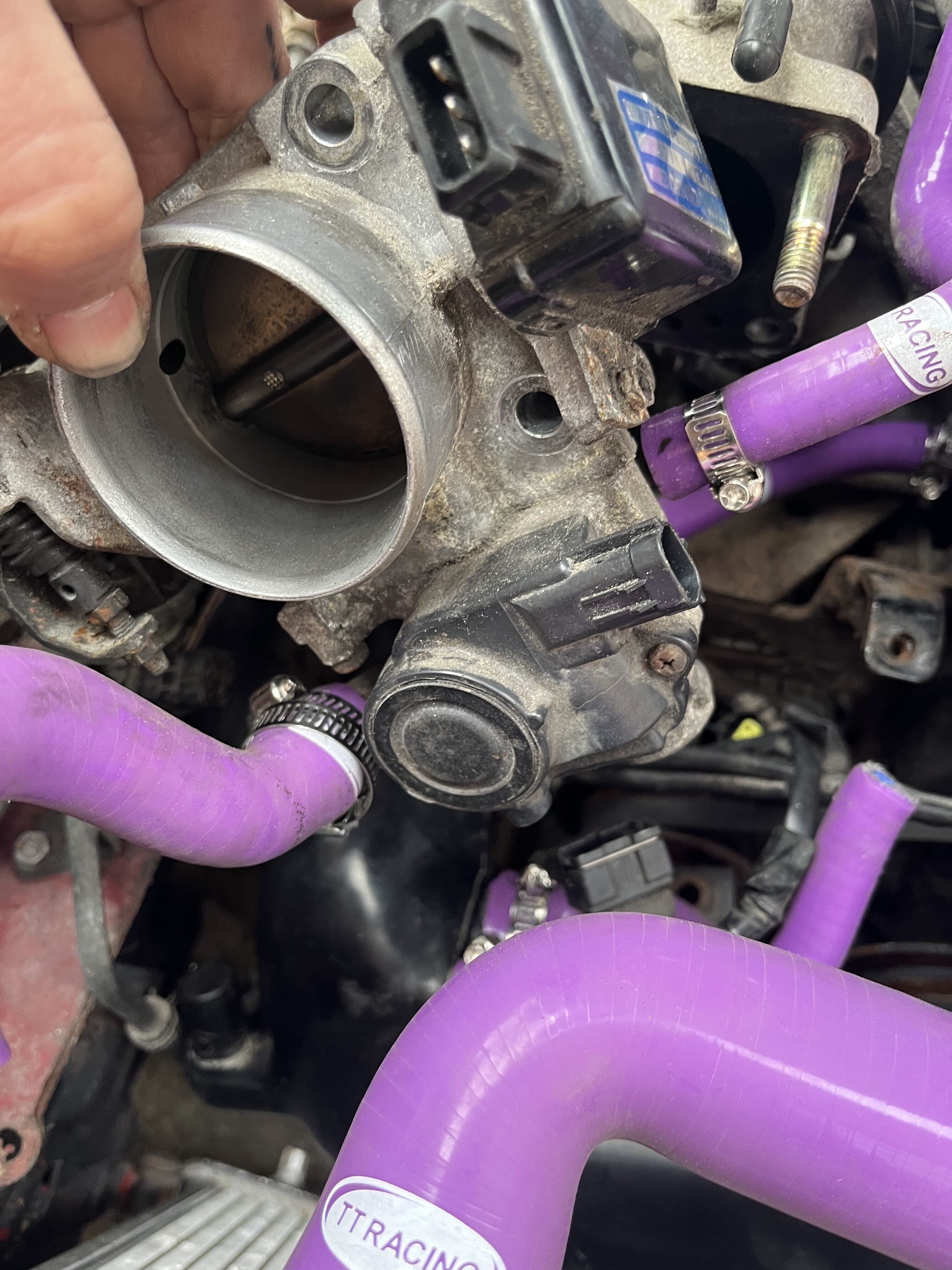

I’m very confused. Was just looking at replacements and none of them seem to look like what I have in the car.
The 1.6 93 looks like a section that bolts underneath the throttle body, this throttle body and iac look like nothing I can find online.
Very much learning on these cars, but does mine look right?
Your help is very much appreciated.
That looks right, 1.8 ones are different.
Thanks. I’ve been researching. Looks like they changed in 1994 so mine is the proper early one at a 93.
I have found a repair video so will see what I can do, otherwise source a replacement.
Thanks for all your help Robbie.
Give this a read. Lot of good information. Looks like the ISCV should be 12 ohms so I would check you are reading the meter correctly.

Hi all that helped.
Finally sorted.
It was the icv. I attempted a fix and did manage to trace the wire back to get 12ohms, but whilst doing so got a replacement with throttle body for £35 which was a good unit.
