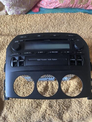

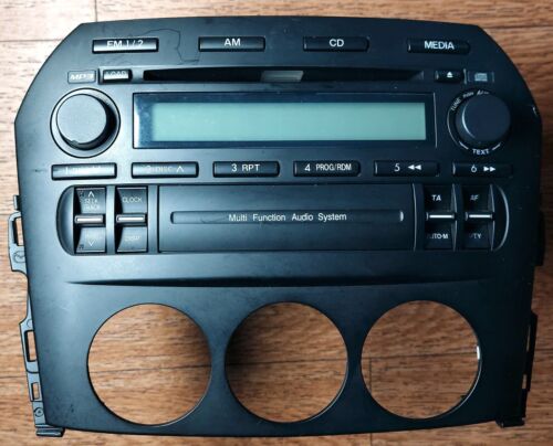

NOT MINE but this has to be worth a punt as a test unit
Or this one if you want to get it quickly
Could still be the head unit - reacting to the damp.
