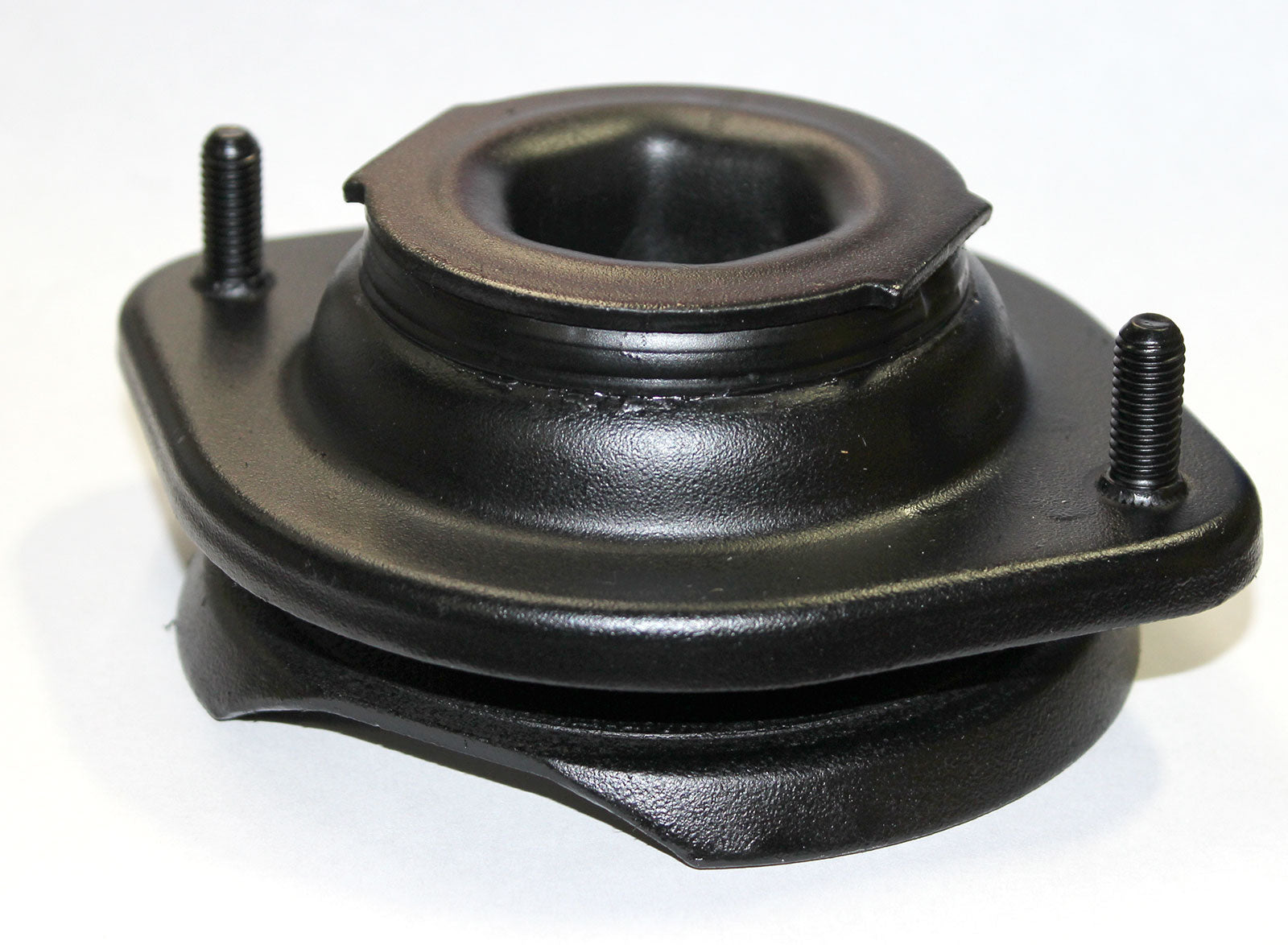

I did ask if you had assembled these with NA top mounts or NB top mounts, and I got a reply that suggested I said to bin the shock absorber.
Photo here of worn versus new;

Sorry ast the reply were I said about binning the shocks was meant for Mazdamenda as that was his suggestion, and not a very helpful one.

They are on na top mounts I don’t have much money so I try to do things myself first, I’m no idiot and work alongside engineers machanics and fabricators all day at my work, im an automotive fabricator by trade so when the old gal starts to rust im not fazed, no idiot but no machanic either. Thank you again
