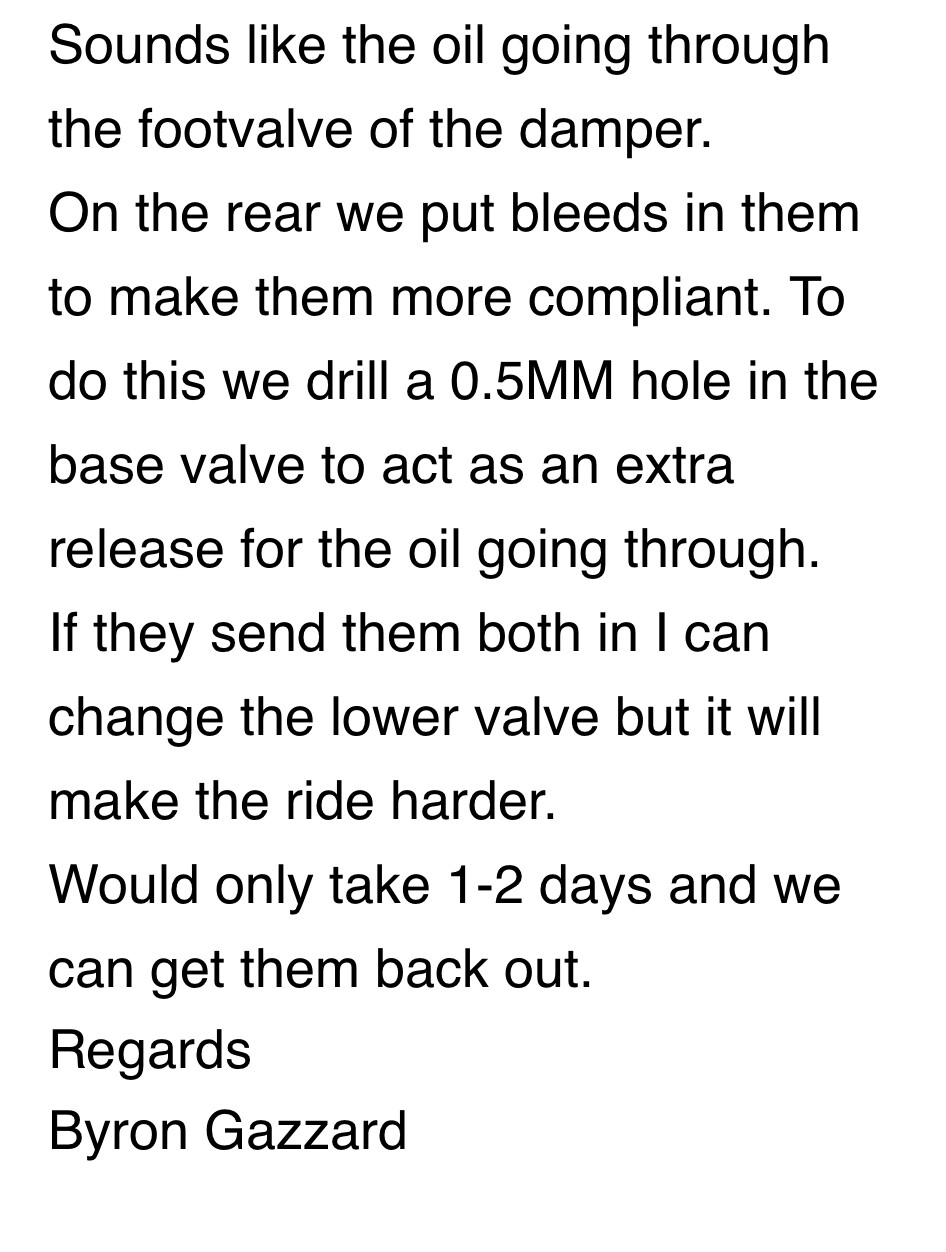

I did send the video and their response was, this is a screen shot of the email I received from Gaz.
This sounds like a cop out to me, I should just get a new shock not sending both the rear to them to drill and change the dynamics?!

This footvalve issue has been cropping up on Gaz shocks since at least 2007. You will see on various forums someone called “The Gazman” talk about this; he is/was a Gaz dealer. In 2007, it was claimed Gaz redesigned the shock to get rid of this. Obviously they didn’t. There is some some suggestion that it comes about because of the use of too soft springs and/or a low rebound setting.
What you will find out now is the limitations of a relatively small manufacturer of shocks. I assume these are under warranty. What they won’t do is send you a replacement shock. They will try and fix what you have, which of course is no good to you, as it doubles the time your car is off the road. And how do you park up a car with no shocks on it.
The smallness of Protec (who actually wanted to sell me an upgraded version) was why I went to IG Racing for a rebuild.
I think the best I can expect from Gaz is me sending it in for a rebuild, the 0.5 hole referred to in Gaz’s email is an existing hole in the foot valve supposedly to make the damping more compliant, they’re initial solution is to change both rear foot valves for ones without holes :man_shrugging:t2:?
But I reminded him that there was nothing wrong with the other rear so a rebuild of the faulty shock I think is preferable. There was no offer of sending me a replacement!
