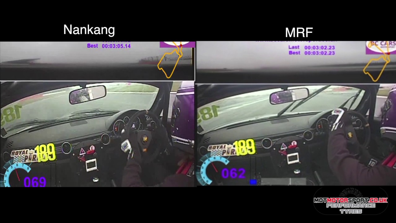

I ran NS2R’s on track in my NC1 and passed one AR1’s as an “upgrade” and went straight to MRF ZTR’s if you can get them in the size you need. They’re a fine tyre.

As the MRF dealer for the UK, I am very cautious about what I say as I am not here to criticise other tyres.
That said, it is absolutely no secret that the NS2R, is, as has been said, a budget track tyre. In the past it was available in different compound hardness’s which offered options to intended use. It is what it is, a road legal tyre, that has, when not worn, decent water clearance and decent performance when at the right temp. It is also cheap for this type of tyre. It’s weakness is it does not heat cycle well and can be past it’s best performance even on it’s second use. This means it loses ultimate grip, which is not that high compared to actual track tyres, and can become quite snappy.
AR1 is Nankang’s track tyre, they have a new track tyre, but at far more money. A fair number of races use them in a lot of different situations. It is considered to come on very quickly, and have reasonable life. However, while road legal, you only have to look at it to realise it is going to be severely compromised in the wet. If you want a general road tyre, don’t. And that applies to all full track tyres. Road is not what they are for. Yes they have road approval, but their actual ability is compromised and since you will never get them to the proper temperature on the road, you actually get no more road performance than a decent road tyre.
If you want to look up opinion on the Internet, then AO52 is the absolute flavor of the month, to the point that it will probably also deliver a baby better than a midwife, but what people will not say is that even without track use, life is unlikely to be above 5k miles and are one of the most expensive tyres going, plus, in endurance racing, tyres being replaced after just an hour’s use is not rare.
MRF ZTR in a medium compound will not be the fastest tyre out there, but will give you very good consistency and long life.
