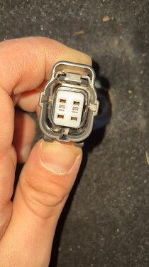

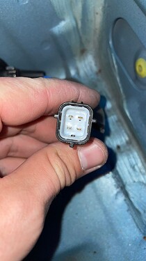

First of all I decided to take a good look at the connectors on the sensor, they look okay? I’ve attached a picture so please do give your opinions.

After that I decided I’d done enough digging around and decided to plug the obd2 scanner in and clear the codes. Then I turned the car on (sensor connected). Initially no voltage (like before). Let the car heat up while I was putting everything back together again & then drove up & down the flat car park - car not allowed on the public roads at the moment. When I parked the car up there was a signal from the sensor (yay) and no EML. Maybe it was just a dodgy connection? I’m not sure.
