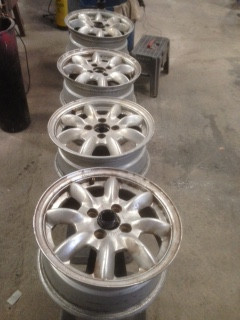

Had old and very scruffy PanaSports cleaned off & painted last year.
Got them dirt cheap. They needed to be…
From 5 feet they are fine. TBH, they were that bad, going full house powder coating etc would have quadrupled their value!
They were truly gopping. Re wrote The Book of Ally Grim.
Not so much now.
Painting is fine so long as the basics of process are observed.
Base coat, 2 colour coats ( Vauxhall alloy code) and 2 top coats all sticky-clothed & imperfections dealt with. £40.00 a wheel.
