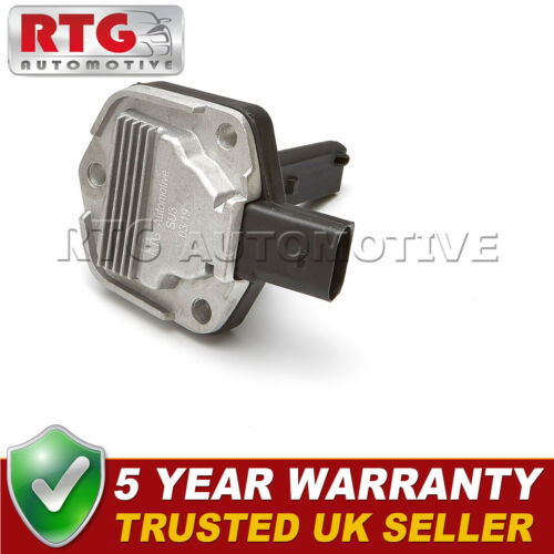

I wonder how much electrical grubbins would be needed to adapt one of the VW group oil level sensors ?
