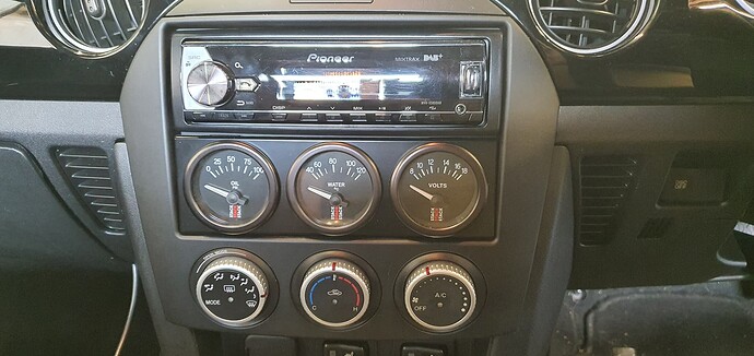

Mx5parts do a 2 or 3 gauge mounting that goes in a single din radio hole. I have a double din adaptor with a single din stereo and the gauges fitted underneath. Its very neat and could almost be stock. I have a picture somewhere I’ll dig it out if you’re interested
Yes please mate. Thanks
Thanks dude. So basically change the pressure sensor and add the temp and pressure gauge? Ok will probably be asking some questions via pm. Many thanks
Pretty much yeah. I used a t piece with an extension so the original oil pressure switch still works. For the water I used an insert in the heater hose rather then the original sensor position at the rear of the engine just because its much easier to access than the rear of the engine. To figure out which hose to use I started the engine and felt which hose got hot the soonest. Using the heater hose also meant that the original sensor is undisturbed so less likely to leak

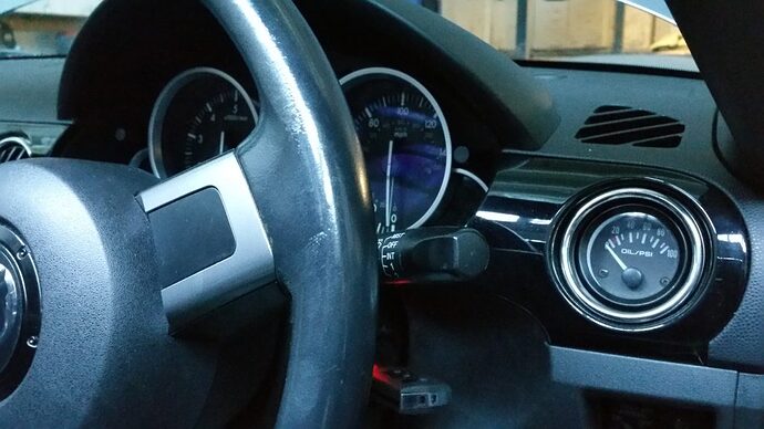

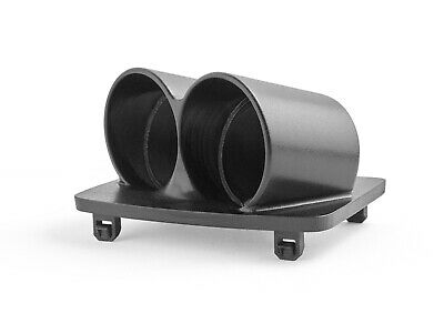

Just another solution fitting the gauges. This is a bit expensive but i think it looks good and is a neat solution. Less hassle and removing an additional expense changing the radio ( I still have the bose radio)
Im gunna check whether that’s actually 3d printed or not. If it is i can probably do a better job designing this but my concern if its a hot day it will deform. But a solution like that is probably better for me.
Looks like a neat solution. Right in line of sight too. Lmk how it goes as I might get one. I’ve been hankering after an android auto setup which are pretty much all double din.
