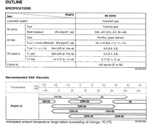

Here you go
Do not forget the sender unit or the gauge could always be defective. One point though is the oil grade. A lot of people talk of the 5w30 but to be honest in an old car that sounds a bit low for me, unless you are going to change grade in the summer. Looking at the above chart I would pick a 10W40 or 5W40 as hopefully you will get some time above 0 deg C.
