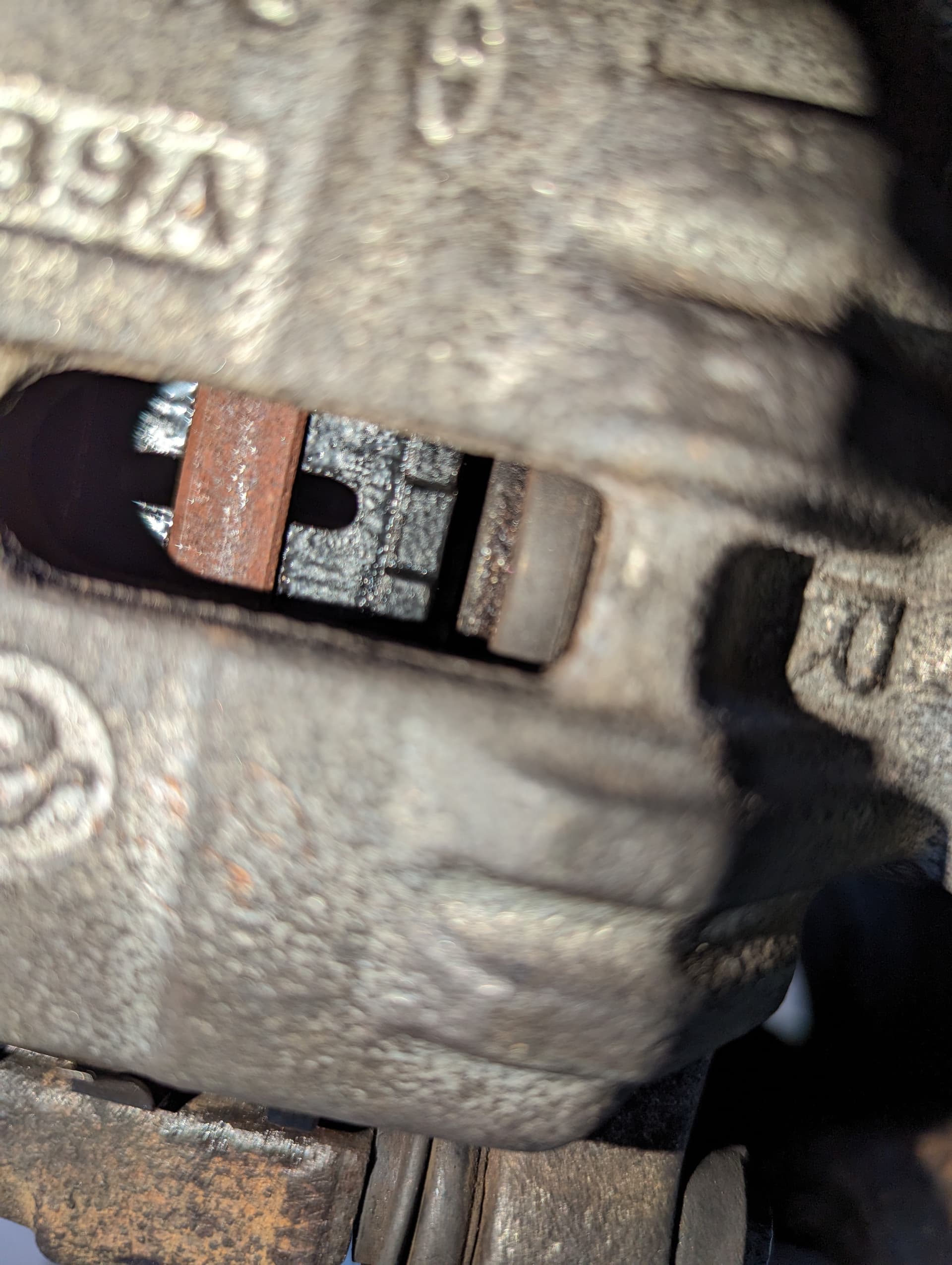

Outside rear brake, outer pad is firmly against rotor

I’ve snapped some pics, first pic you can see that the pad is right up against the rotor. I have pushed the rotor flush as if the wheel was secured. It rubs

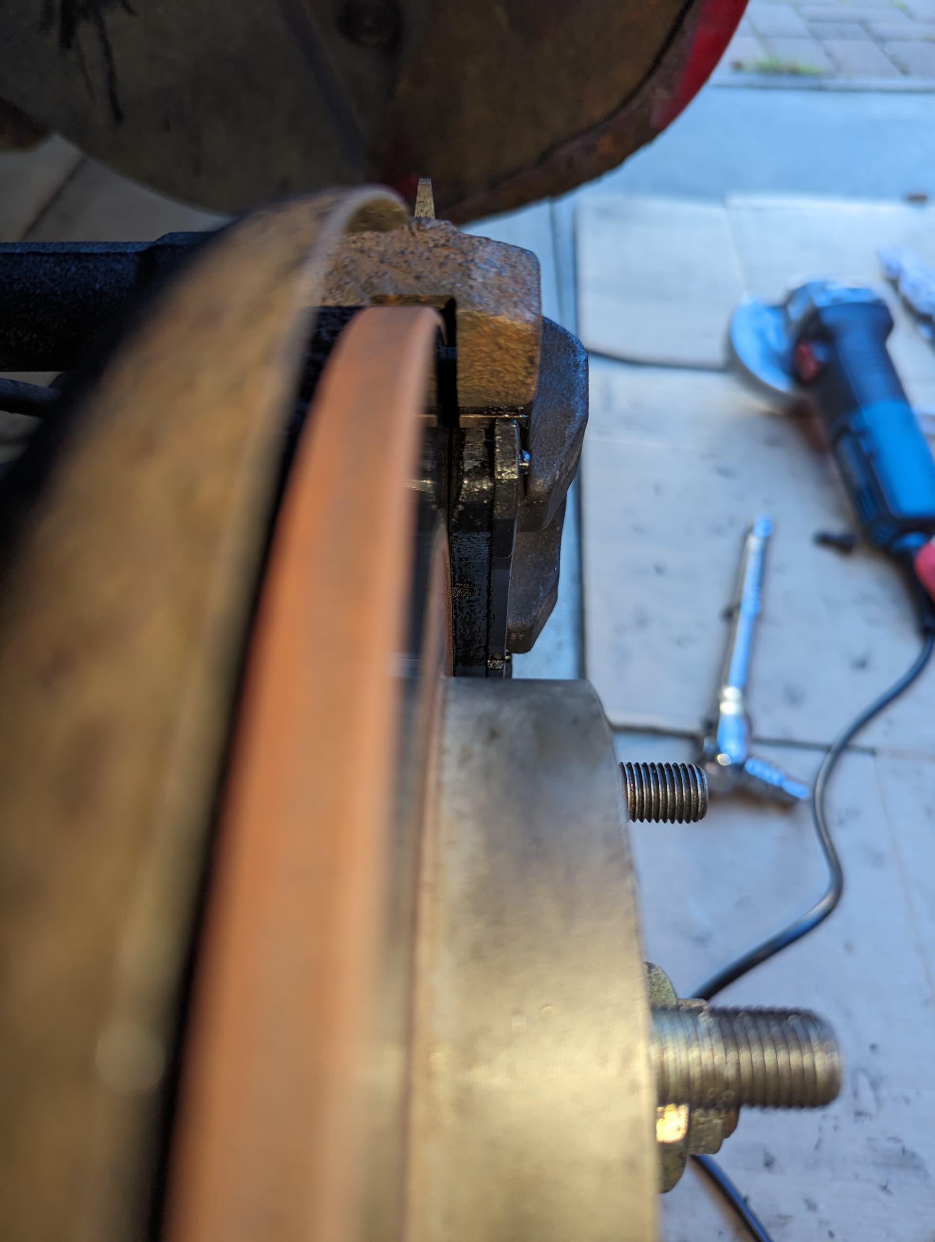

This pic here is the opposite side with the caliper wound all the way out. The caliper simply can’t come over far enough. I know there is corrosion on the piston, I’ve already had the seal off and it doesn’t appear to extend into the housing.
What could be causing the outside pad to sit so tightly on the rotor like that? The other side is fine, like it rubs ever so slightly but not enough to be of concern.
Wind the piston out onto the disc. I would hold the disc in place with a couple nuts so it’s fits flush to the hub before any adjustments.
So done this, ran it out until it locked up then backed off 1/4 of a turn. Can see light ever so slightly through it.
I’ve been at this point a few times, from here it is still binding, needing a bit of effort to turn with the wheel off. With the wheel on, it’s binding heavily. I also tried giving the brake a good stomp to make sure the caliper is sitting true but still the same.

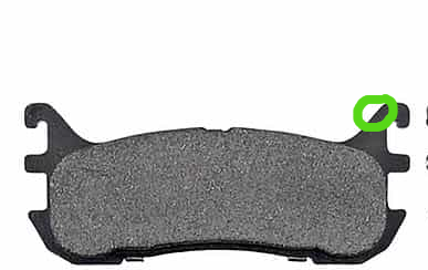

I’ve managed to solve this. I just don’t think the tolerances in the pads are great.
The actual caliper itself was pressing down on the pad, which of course was pressing it into the spring clips nd preventing them from moving. In order to get the bottom slide pin in, I had to apply light pressure to align the threads. However when you let go, I now had the inside of the slide pin bore pressing against the slide pin, causing even more bind.
I modified the pads slightly:
modified-area
So the great area is where the caliper was putting pressure. I skimmed that with a cutting disc and removing a hair of material, and now the pads fit perfectly with zero binding, wheel does a good turn before stopping.
