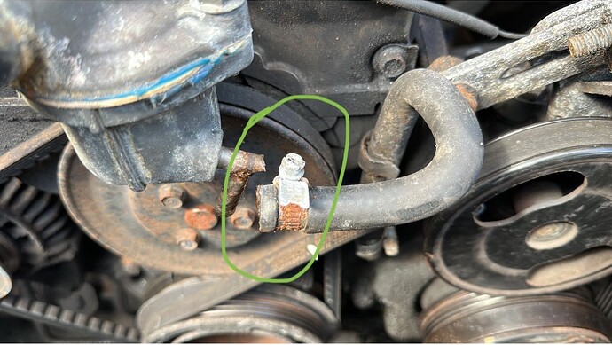

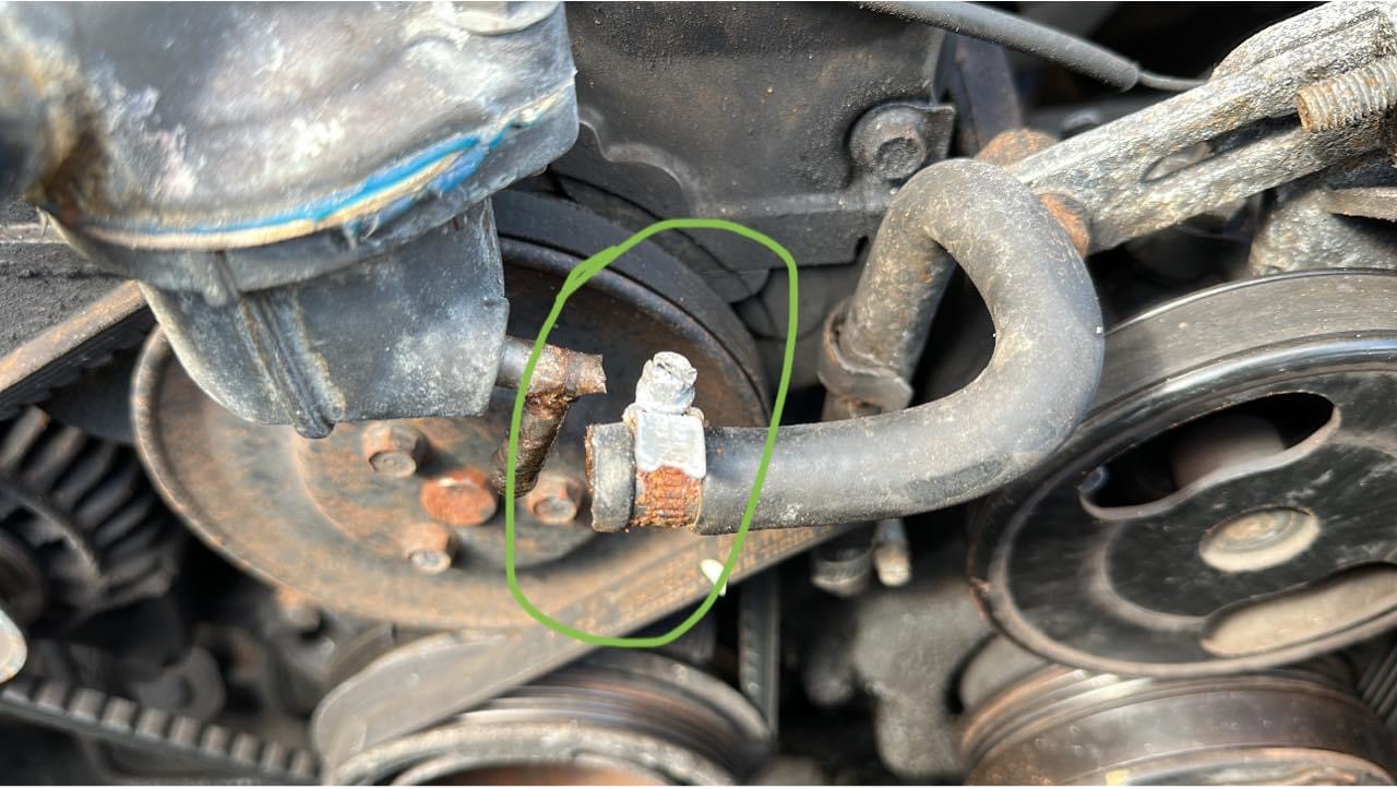

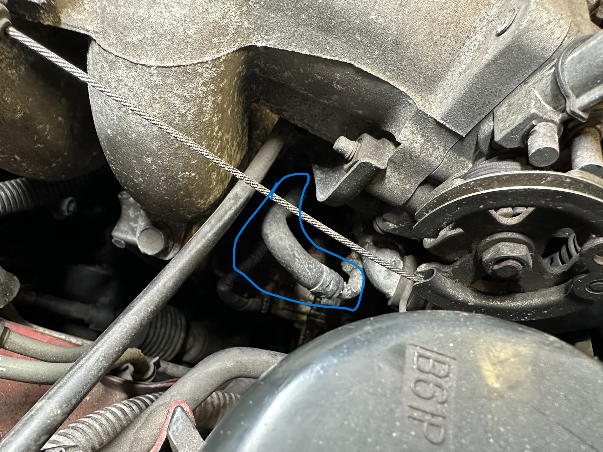

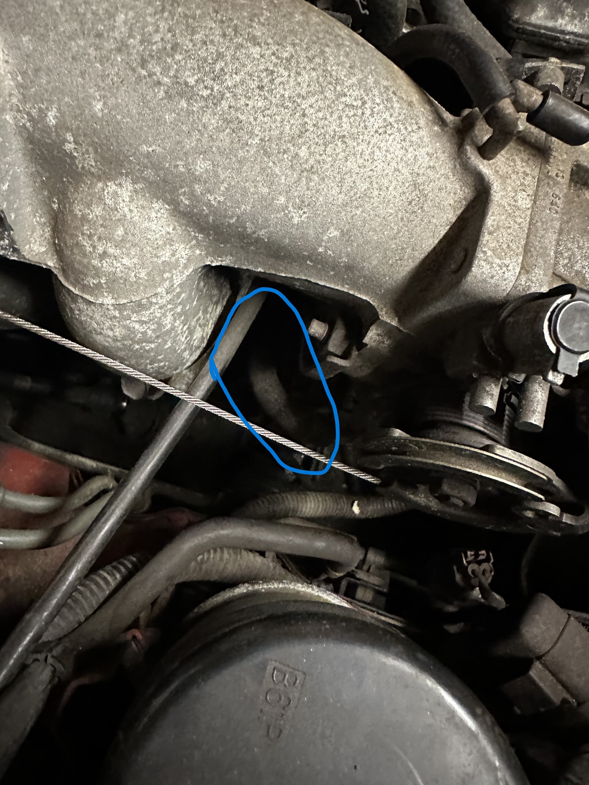

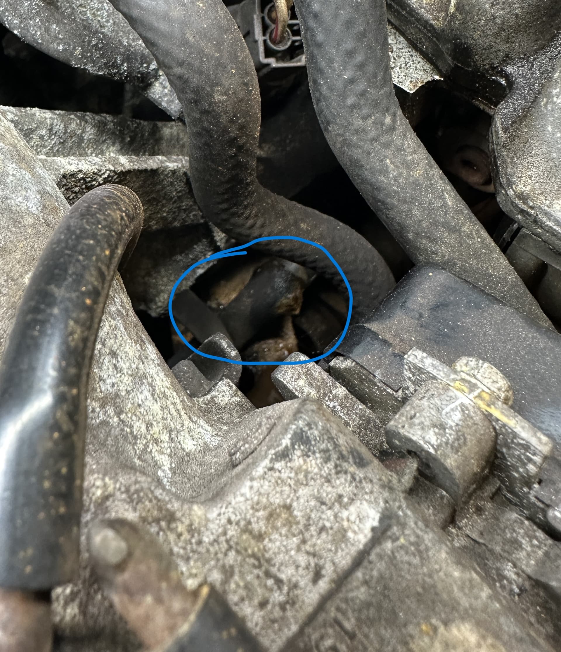

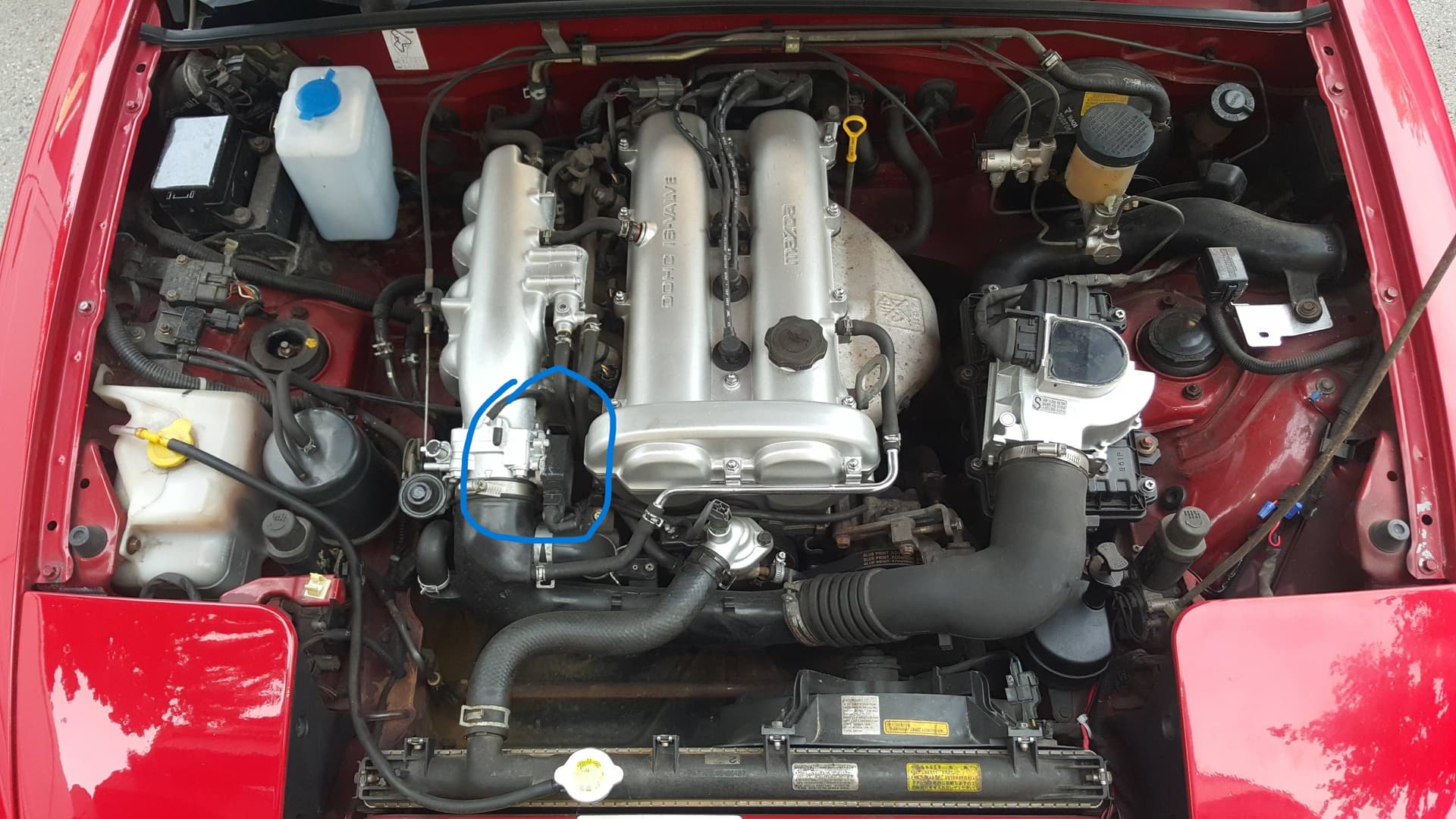

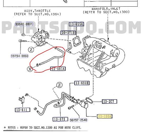

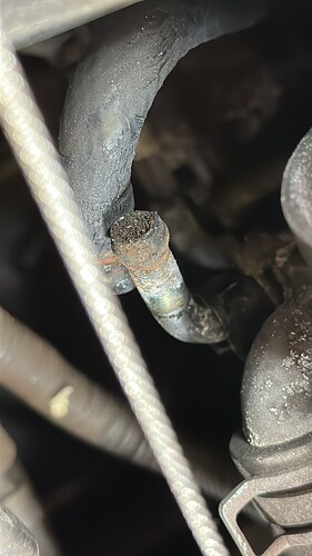

I’m not sure if the fans were running, they might have been, i didn’t hear them, but when i turned the ignition back on, they kicked in. The leak appears to be coming from a pipe under the intake manifold, behind the throttle body. I’ve circled it as best i can. the end looks rather crusty.

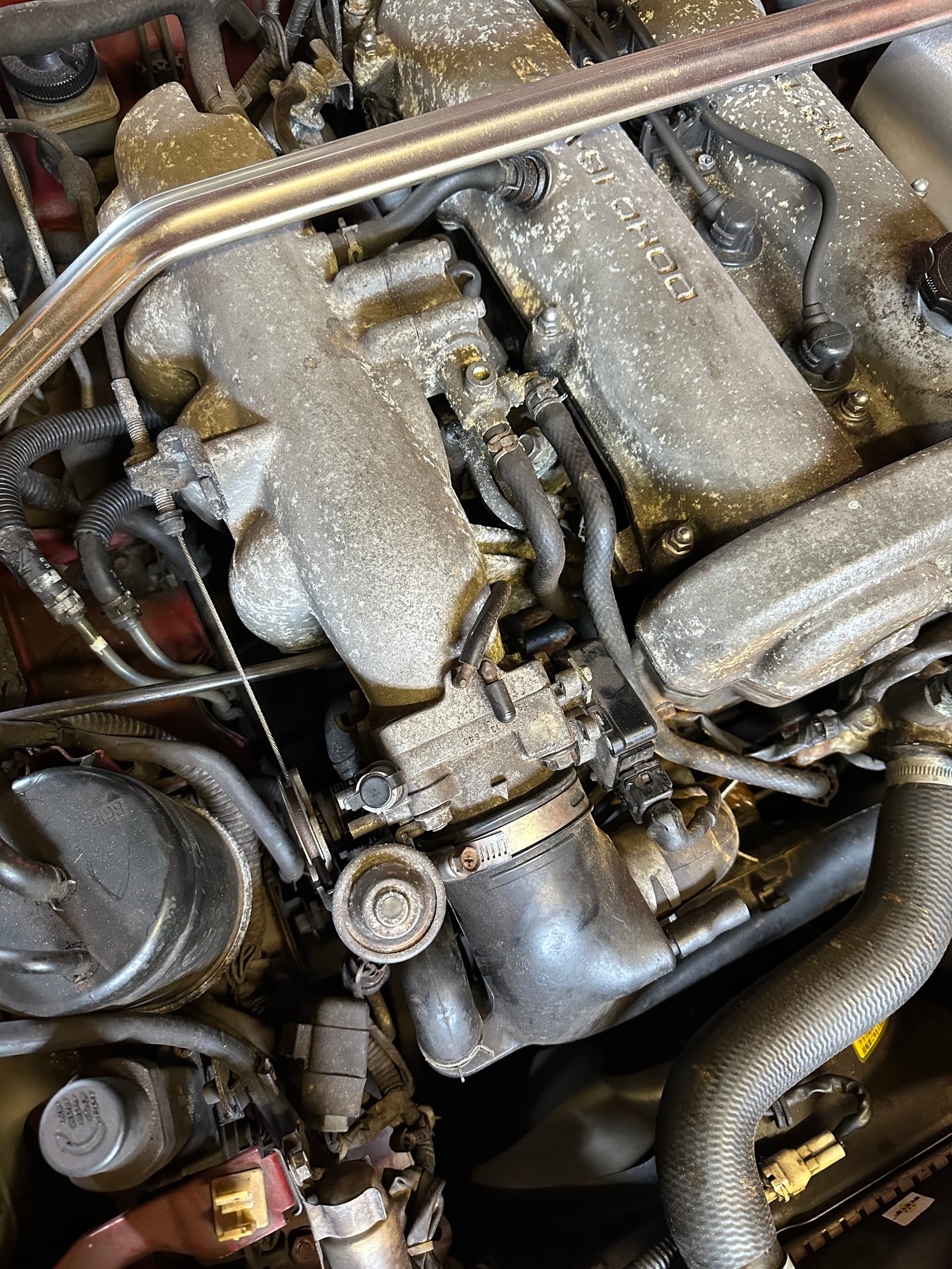

(for reference, its about here)
the pipe didn’t feel too hot to the touch, maybe because all the water had vented. There wasn’t alot of water on the floor.
I’m terrified I’ve cooked the engine, but as i say, it never got to the top of the gauge, maybe two thirds, and perhaps it just found an old weak hose that let go?
Looking for some reassurance and advice, does anyone know what that pipe is for, where i could get a replacement? It looks pretty hard to reach :confounded:
ICV, autolinkmx5 as them in stock,if that one as given up, chances are the others are also the same age, personally if the budget will allow , then i would change the lot for piece of mind.
how long was she having her steam off moment for before you noticed? if she did not hit red then it sounds like it was just spraying out and venting off from then hitting hot metal , she will be fine.

So took another look this morning, everything has dried up, except that line, which confirms its leaking to me as water is wicking out the hole.

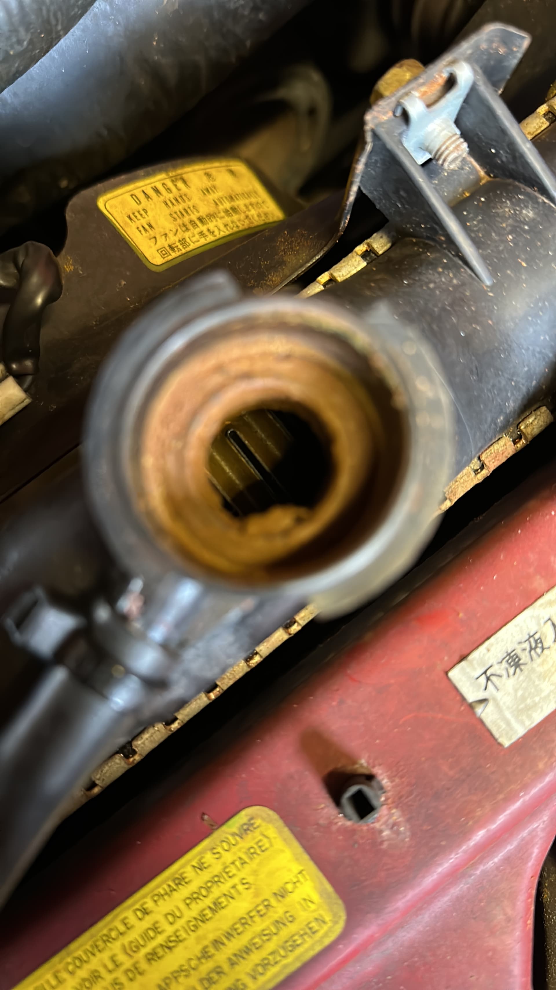

I popped the rad cap off this morning now its cooled, and its VERY brown. Could definitely benefit from a flush?
Then she will be fine, it looks like she does a lot of sitting about, and is time to look at overhauling the cooling system completely, hoses ,rad, thermostat etc, when was the last time the water pump was done also.

Went over to Brayley Mazda in MK on my lunch hour, and the 3 lads in the parts team spent a good 20 minutes going through their diagrams, and meant that we eventually managed to identify the offending split line. Its a B61P13681B
but I think I’ll just order an entire kit!

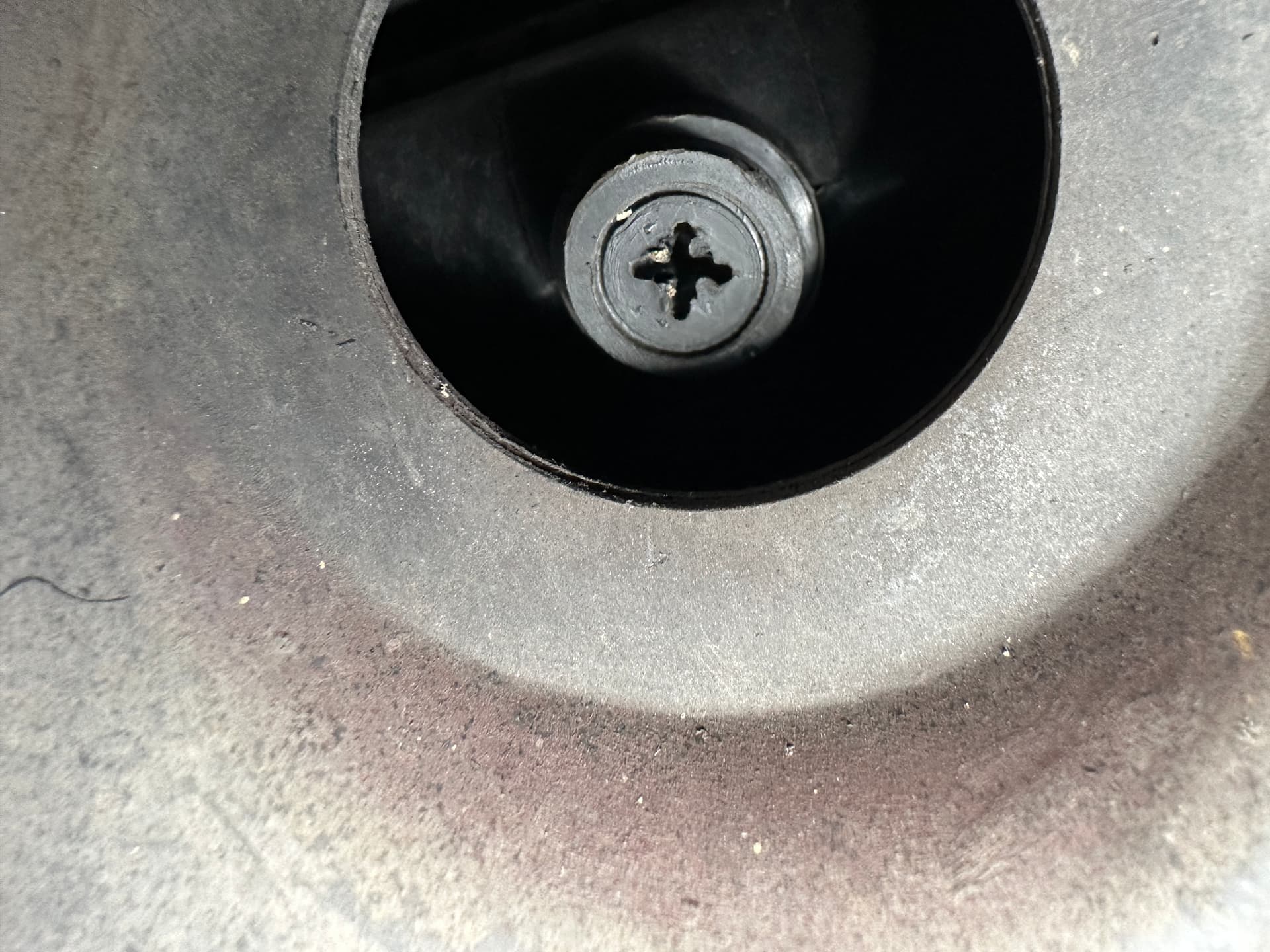

The drain plug is a plastic cross head plug on the bottom of the radiator that will been a JIS scfrewdriver. It strips easily. Alternatively pull the bottom hose.

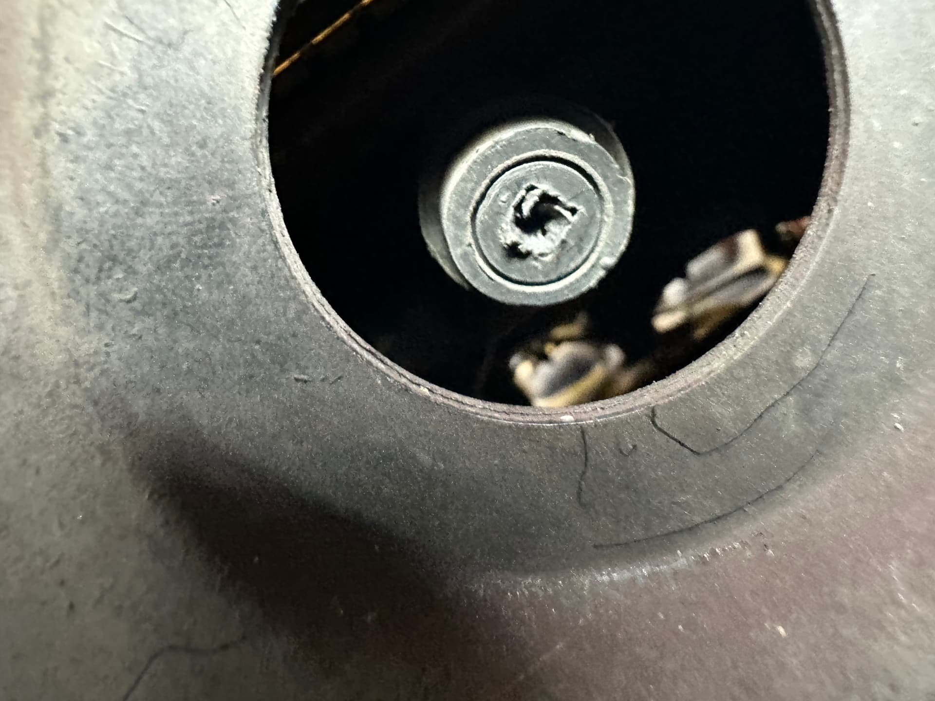

I replaced the line on Thursday, then on Friday I drained the coolant. The drain valve on the bottom of the rad striped the second looked at it,

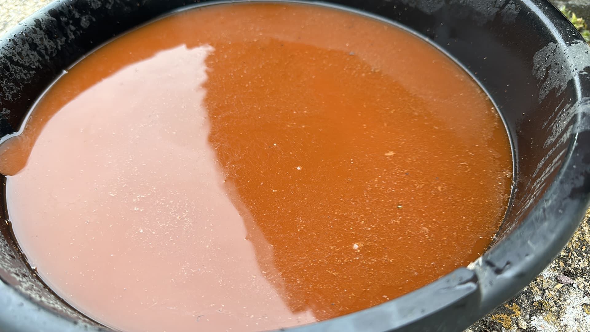

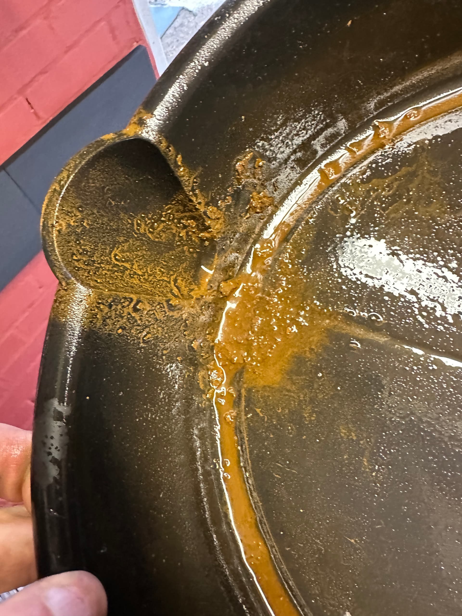

so I dropped the undertray and pulled the bottom rad hose. The water that came out was pretty grim,

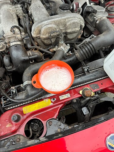

I’ve refilled with distilled water and Rad flush, bled it, and everything seems fine.

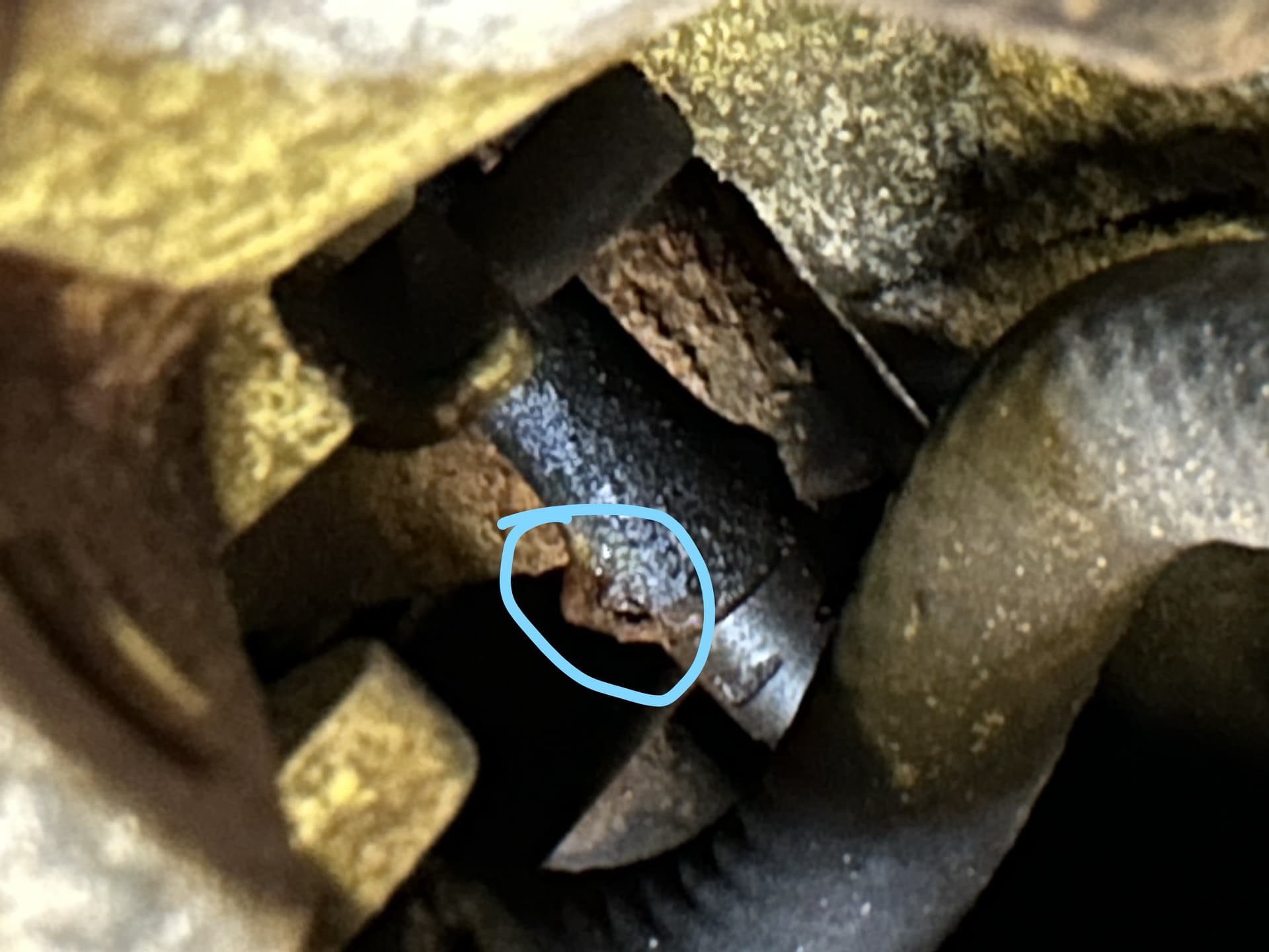

Next weekend, I’ll drop the coolant again, and run another load of water/rad flush through, and while there, a friend is going to help me swap all the other lines over, as well as try flush out some of the blocked lines. (this is the pipe the line that failed was attached to. It pressurise (clearly as the hose attached to it split when it got hot), I couldn’t blow air through said failed hose so it too was blocked, and the replacement one doesn’t get warm even when the engines up to temp, suggesting there is little to no flow (I unblocked what i could) this is off the bottom of the Idle Control Valve. Perhaps explain why she doesn’t ideal well/smooth/is too fast?

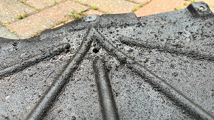

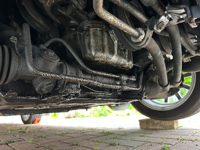

While under there, I noticed alot of oil, on what I suspect are the powersteering lines? Something I should be concerned about?
Looks like its all been well over due…time to strip it all down and sort those oil leaks also asap, otherwise you are wasting your time, but for any of those that might hit the rad drain plug issue…and just make sure on re fitting its smeared with a lick of red rubber grease to stop it sticking but still seals…
M-m
Clean it all up, reckon the crank seal is leaking.:thinking:

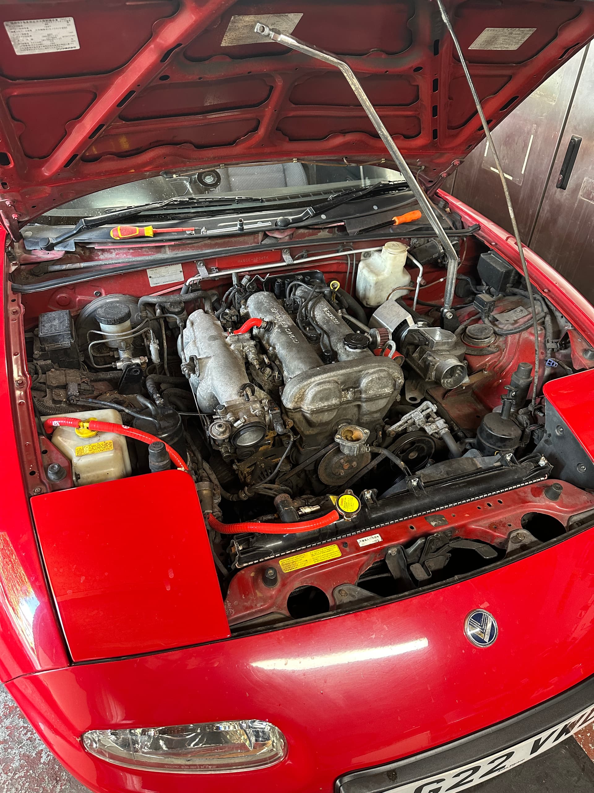

So the saga continues. Took the car up to a friends at the weekend, plan was to change silicone lines, oil, oil filter, plugs ech.
We got some hoses changed, flushed a lot of lines out, but the idle control valve is totally blocked. Then, we attempted to change the line that comes off the thermostat housing… well…
The line snapped clean off with minimal force when we tried to remove the new line.
So new thermostat housing on order, I’ve also ordered a thermostat too since its open now, as well as a new ICV
since its filled with sludge.
At least the oil change/filter went smoothly. Ended up having to get a lift home, as the car is off the road. Getting the train back up on Saturday when we’ll hopefully get all the parts swapped over.
