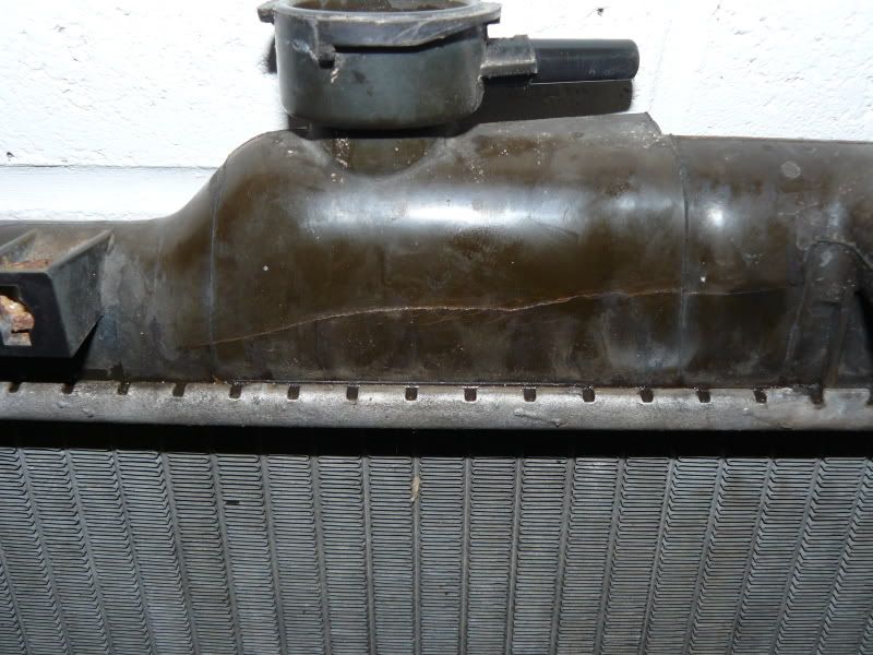

Antifreeze lying around the top of the radiator; the plastic is cracking around the filler (common on original radiators); new radiator time. The pattern radiators are fine, and even the Mazda rad isn’t that expensive. The crack may not be obvious, and might only open up when the rad is hot. This crack was on the engine side, and only obvious with the radiator removed;

I checked the coolant and ran the engine for 20 minutes, when the coolant heated up coolant vapour came from the radiator just under the plastic top section, so radiator required.
