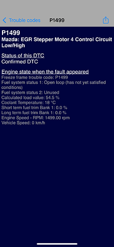

  3. I’m looking for technical help or recommendations on: _Error Code P1499
  4. I have currently an engine management light on with error code P1499

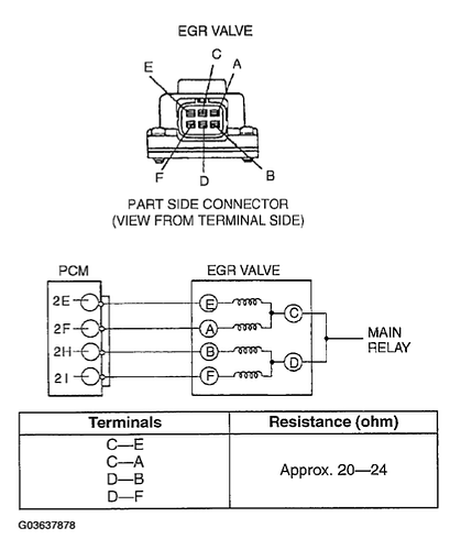

    I checked the resistance across the pins / coils of the EGR valve.
    These were the figures
    C-E 22.5
    C-A 22.6
    D-B 23.4
    D-F 0.6
    As D-F was out of tolerance I replaced the EGR valve. I started the car and no EML on. Happy days I thought!
    I went to use the car this morning and the light is back on with the same code?
    I checked the resistance figures on the new valve and they are all in between 20-24.

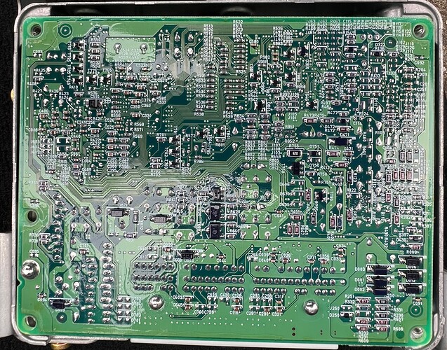

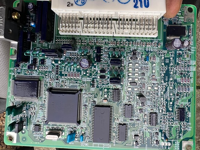

    I have had a look at the ECU and there does not appear to be any chips burnt or damaged.

It’s not what you want to hear and it’ll probably cause you a world of pain and I know that you can’t see anything but I’d guess that the PCM is fried. The EGR valve has basically gone dead short to ground and taken the PCM with it. If you can find someone to repair it, good on ya, but I suspect that you’ll be into used PCMs, immobiliser units, lock sets and keys.

I have tried to get the ECU checked and tested with no success. I am now trying to source another ECU, lock set and immobiliser.

Update: I fitted another ECU, supplied by Rob Rhind (rhino666) . Just been out for a fifty mile spin and all seems good. :+1:
