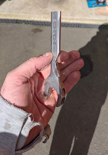

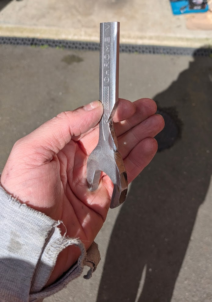

Good news! After butchering a spanner for access (see image), I got the EGR pipe tightened up and took her for a test drive. LTFT is sitting at 0% most of the time at idle, non pending codes, and she’s definitely running slightly smoother on idle.
Not sure how it got loose in the first place, but the car has had an engine swap in the past and wouldn’t surprise me if the EGR has been done and not torqued properly. Hopefully this helps someone who may have the same issue.
