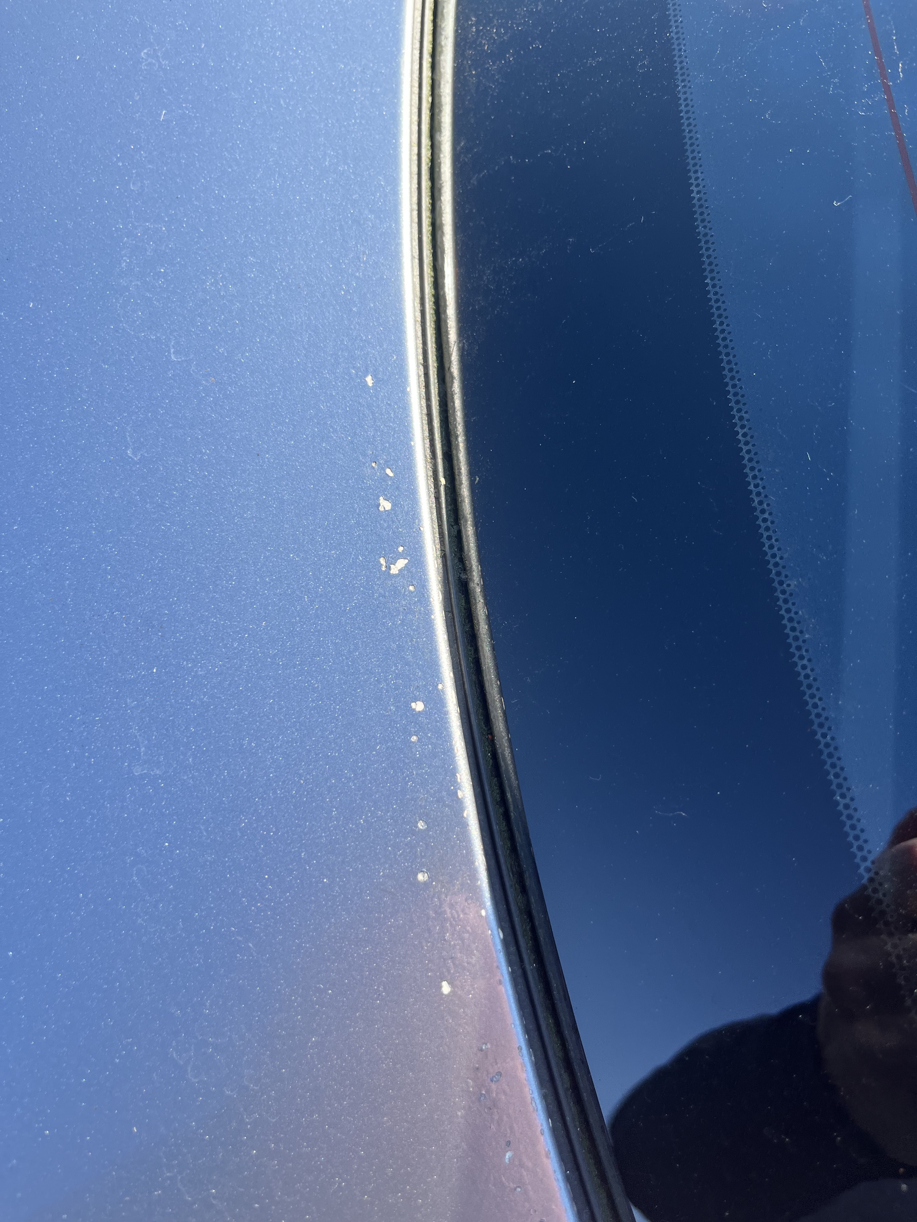

Despite being kept outdoors in a very wet climate, the paint on my car has held up remarkably well. However, I’ve noticed over the last year or so that the edges of the section which lifts to allow the top to retract (not sure what the section is called) have started to chip.
It’s happening on both the front and back edges of the section and the white undercoat is showing in most of these chips.
Before I speak to anyone about getting the paint touched up I would like to understand the cause of the problem. Any ideas?
Is it the known problem with the PRHT deck paint?
Thanks for the response. It’s not the bubbling - which I had on the bonnet, and which required a respray. This is a much more distinct series of chips along the edges. It looks like they have been banged against a hard surface repeatedly.
When I retract the roof the panel doesn’t seem to scrape as it settles back into position, nor when it lifts. Moreover, I’ve hardly had the top down over the last year because of a combination of bad weather and being out of the country for large parts of the summer.

On closer inspection it’s actually more like the paint has flaked off rather than chipped. What I don’t realise until reading this forum was that the deck lid isn’t actually made of metal. On the plus side, the flaked off areas won’t rust but I’m still a bit puzzled as to the cause. Do you think these bits could be touched up, or need a respray?

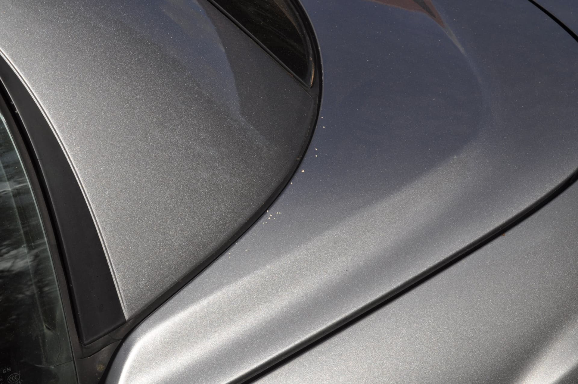

I had this on my NC2 and it was present when I bought it. I put it down to a reaction of the paint with the composite panel, possibly caused by expansion and contraction with temperature changes throughout the year. Coupled with the fact it’s the leading edge of the panel - particularly when the hood is down.
It didn’t get any worse in my ownership and I did discuss it with a bodyshop. It would have needed a respray to sort, and careful prep of the panel would be required to try and avoid it happening again. But they couldn’t/wouldn’t rule out it coming back again in time.
EDIT: this was mine, similar number/locations of the ‘dots’ on both sides. I used a Mazda touch-up paint with a small artist’s brush and that improved the overall look:

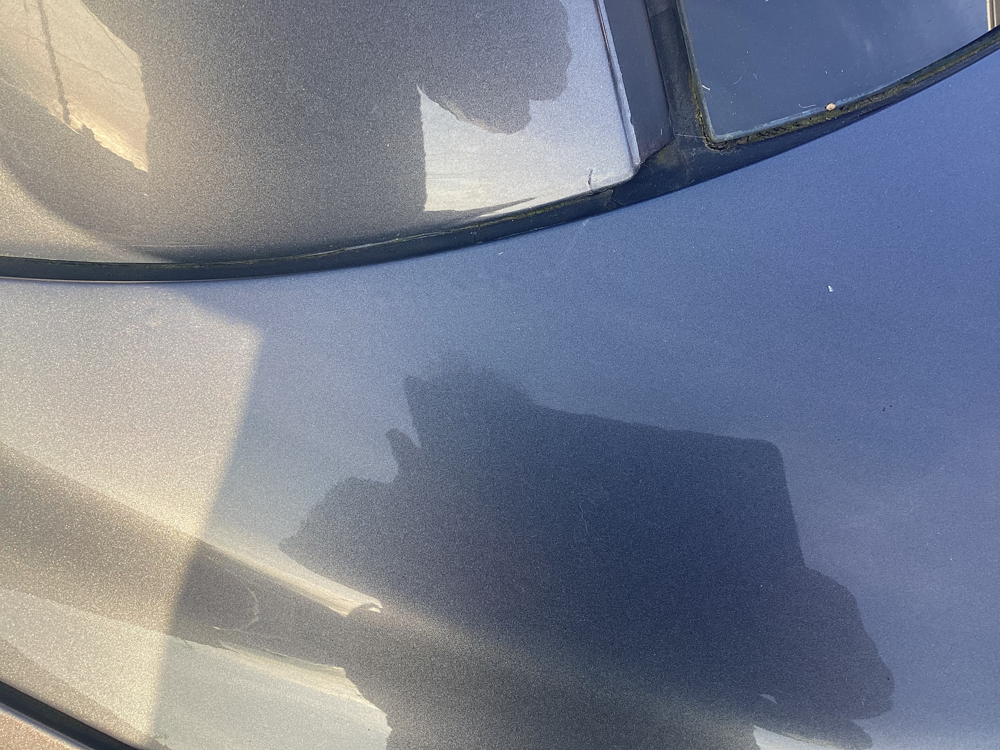

This is an example of non Mazda touch-up paint…

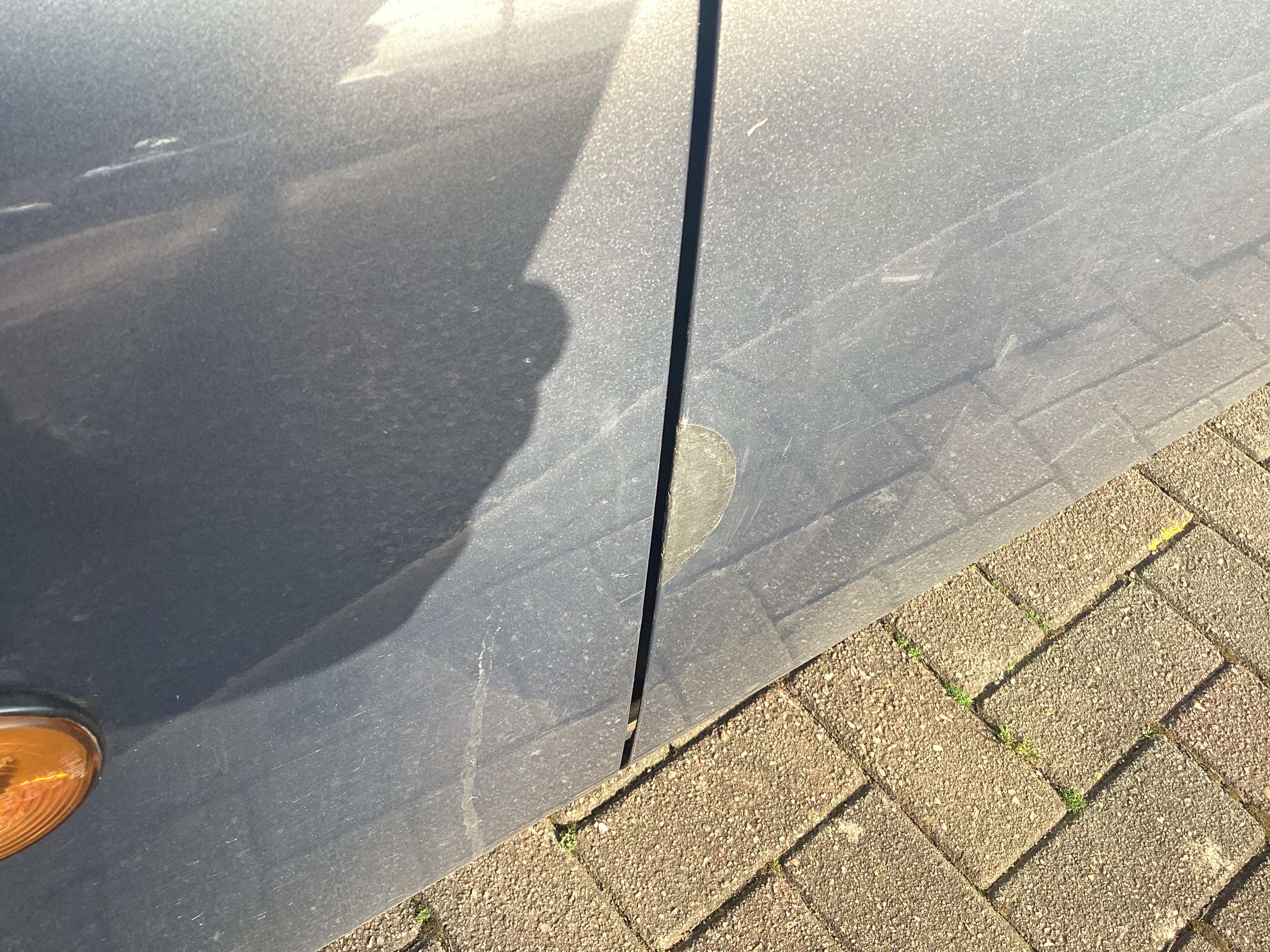

This is my damage in the same area.,
Not as obvious but quite a coincidence
