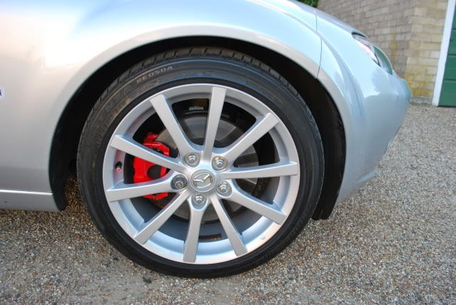

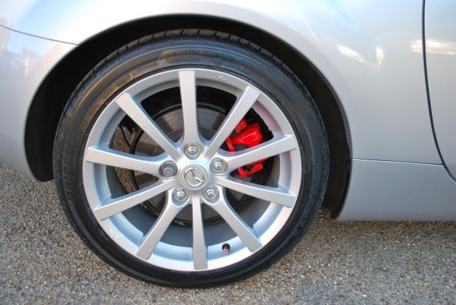

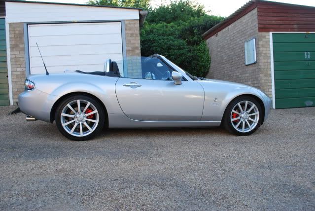

Heres one I prepared earlier:

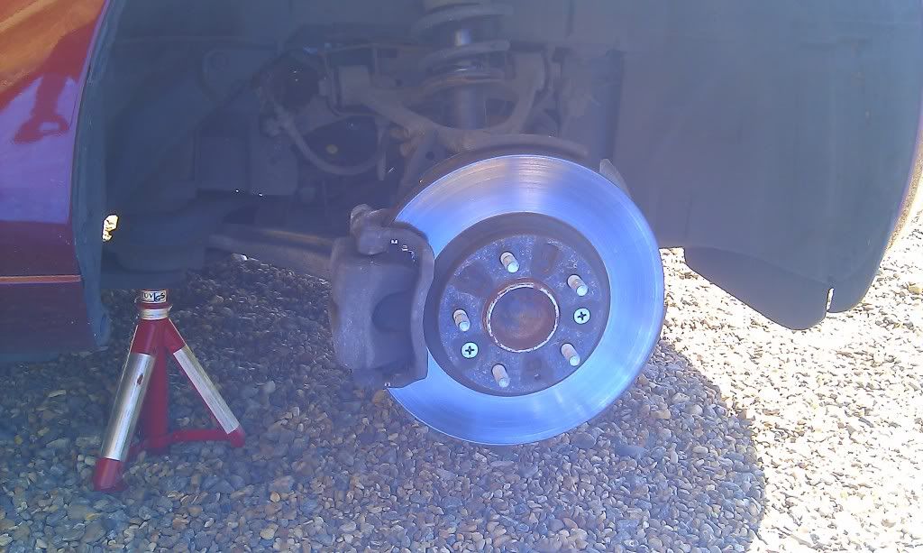

 Here’s the update as promised.
I bought the Halfords Caliper Paint (in bright red) a couple of brushes, some cleaning wipes, a wire brush and a pair of axle stands (nothing like being prepared).
Not knowing one end of a spanner from the other, I am extremely grateful to Roadster Robbie for getting the car onto four axle stands and showing me which bolts to remove to free off the calipers and remove the carriers. After a good clean, a spray of degreaser and a wipe down, the painting began.
Spent a couple of hours or so working around the car applying 3 coats to calipers and carriers. After another hour for the paint to be touch dry, Roadster Robbie reassembled the brakes (wouldn’t trust myself with something that critical), and I tightened the bolts, a quick touch up and replace the wheels, off the axle stands and the job’s a good 'un Thumbs up.
The most technical thing I’ve ever done with a car - here’s the results

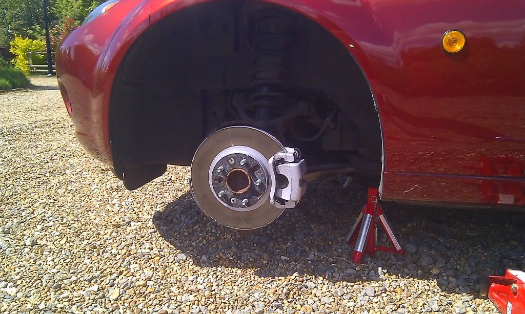

 I painted up my Calipers yesterday. I used some Hammerite smooth and went for rather standard silver but think I’ll go red on top with white Mazda decals,just wasn’t sure if it would go with the copper red body colour!?
This is how they turned out, They’re pretty stealth now, but I think I’m after a more sporty appearance!
looks awsome ill be doing mine on payday :slight_smile:
