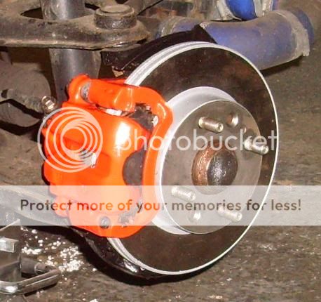

I did my calipers last year with Hammerite red, still looks great now.
             Hi Ianmx5
                          Is the mazda logo on the caliper stuck on or does it come inbossed and painted.i painted my calipers last year with red hammrite and also have black high gloss wheels but they don't look as neat as yours, maybe the mk1 calipers are different .
Hi, the Mazda decal is stuck on and still looks great now with no dis-colouring 19 months on. I do clean the wheels & calipers on a weekly basis.
You can buy the decals on ebay,

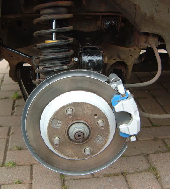

Hiya all.
This was my attempt at painting calipers, discs & shields…
Firstly I removed all the parts requiring paint with the exception of the shields which were painted in-situ.  Then, using a grinding wheel with a wire brush attachment and cordless drill with various shaped wire brushes, I carefully removed all the gunge and rust.
I painted the shields with 2 coats of hammerite smooth in black.
I then masked up all the parts and applied 2 coats of silver hammerite smooth to the discs, and 5 coats of hammerite smooth in red.  I left them to hang on an old clothes stand between coats with electric cable (I split some 2.5mm twin & earth for this).  Allowed 4-8 hours between coats, putting the stand in front of a radiator to “Bake”
Removed all the masking, and chucked them back on the car resulting in this…
Hope this is of help, and thanks for reading.
