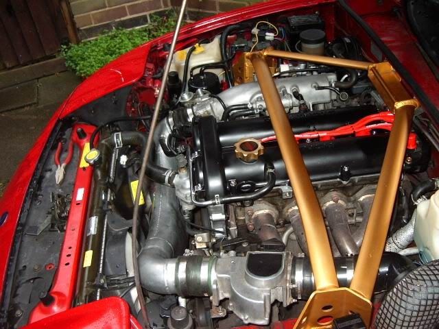

This was one I did on a previous car

One of the first things I was planing on ! Gold car ??? Colour of rocker ?
