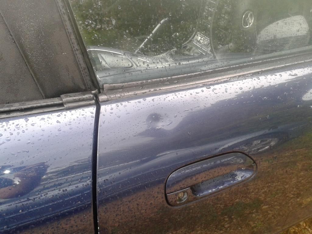

For anyone curious, here is a pic of the dent. Does £70 seem fair?
Sad about your dent  but it looks a bit severe for a non paint repair as removal must leave cracks in original paint with longer term rust potential.  Interested in what others think but perhaps you should get some quotes for a “proper repair”. Good luck

I still have one dent in an almost identical location to yours (see below)
The pdr guy stuck a bar down the door between the window and pushed some of the dents
out. They virtually disappeared although in the right light you can see a slight wave.
The dent beside the door handle would not come out, however, because there is a strengthening bar
just there on the inside and the pdr bar couldn’t access the bodywork. I have since tried
to pull the dent out with glue. That didn’t go well and all I did was pull the laquer off.
I’ve been quoted around £120 to have it sorted in a body shop.
With pdr, it’s a bit of a lottery. It can work brilliantly or you can spend £70 only to be told you have to go to a bodyshop anyway.
