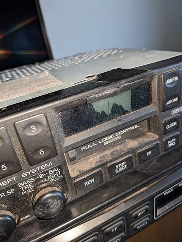

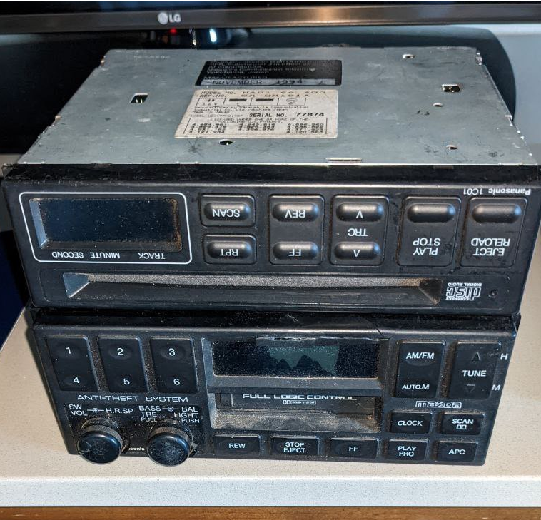

Bought original cd + cassette players from a guy in the us, unsurprisingly usps damaged them and broke one of the screens on the cassette player.
Don’t know if they exist but if anyone knows where or if i can get a replacement screen from someone, any info would be great. Also if anyone knows how or where I can fix the crack in the plastic around the screen would like to know.

You’d probably pick up a JDM spec one of those from a UK breaker for peanuts (I’ve probably got a spare I’m my garage even), I’d bet that you could swap the facia over from one of those.
