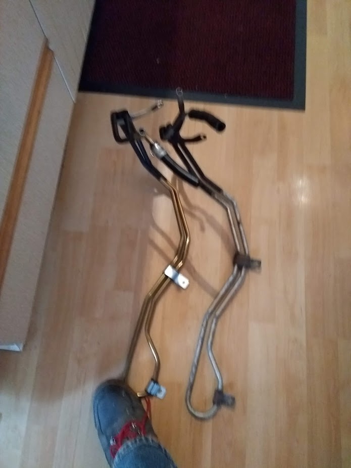

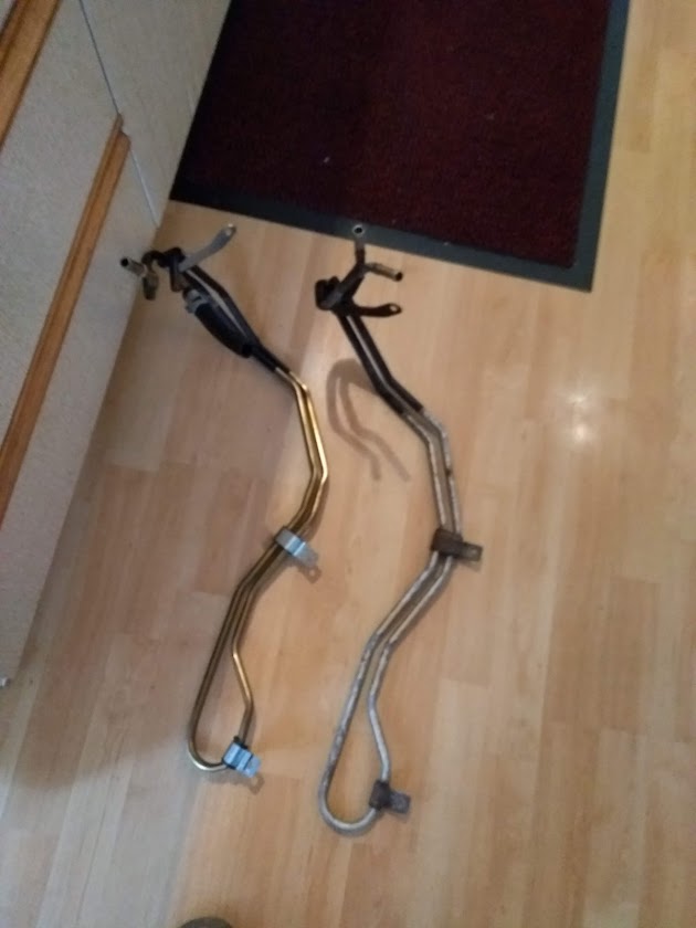

The pipe I have looks to be way out of whack!
The ends point in a different direction and the centre bracket is in a different place. Was really hoping to get the PAS working again today :neutral_face:
Won’t the bracket slide along the pipe to match the other one? Is it a used pipe? (Looks like a cut rubber hose on the end). Could it maybe have got bent on removal and will bend back to the right position?
Hi Robbie, I moved the bracket as you say and got it fitted. I think you may be right and it got sat on in transit so will try and bend it back. The sellers should send it in a box really, doing so probably puts the post up. 'Was offered a refund, just after I got it fitted. It’s definitely new, I think they all come with a new piece of hose on one end.
