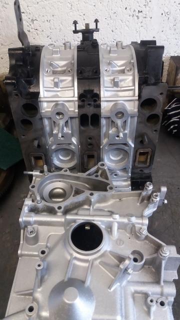

Yes hayward rotary rebuilt it. Would of done it myself but didn’t want to chance wrecking the iron porting it.
A lot of the rx8 pub talk is myth, yes they suffer failures but mostly down to put maintenence. Carl who rebuilt my engine is on 130k miles with no rebuild and he puts it purely down to proper maintenance and using 10w40 oil.

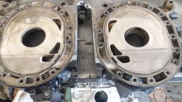

Was pretty clean when I stripped it
WOW!!!
