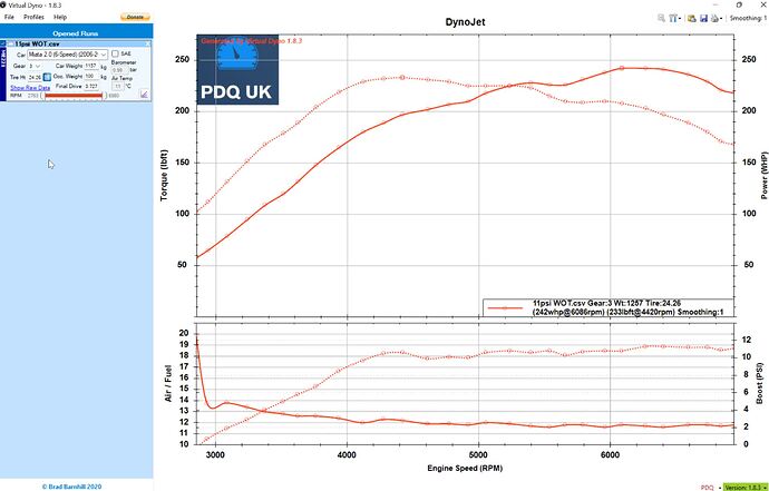

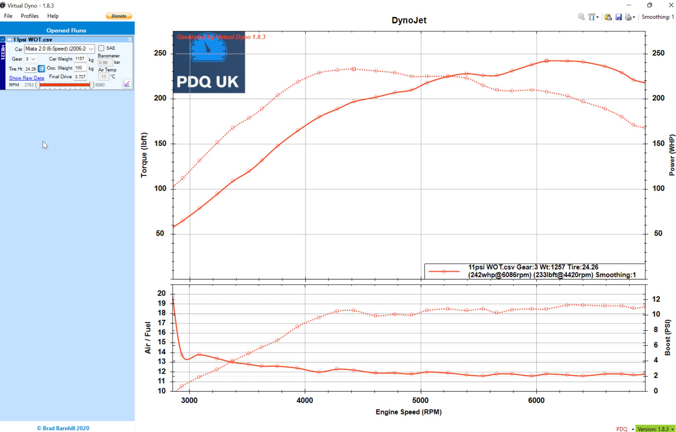

Hi mate, i have been following this thread but your dyno curves have really got my interest.
Do you still use the stock cams? I suppose you also got an intercooler fitted as well? Stock clutch, flywheel and gearbox?
Hi - those are only VirtualDyno so until I get it on a real world dyno I won’t know for sure, but I have had good experience of VD in the past for the ball park figures/shapes.

Those numbers seem to match those seen by others running similar boost, roughly.

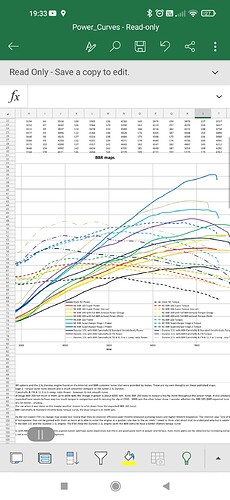

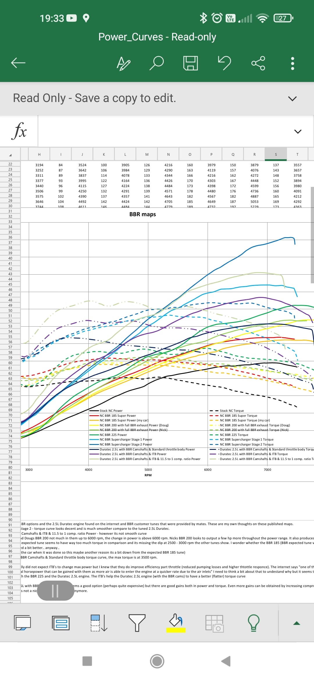

On the bbr curves i have seen the NA seem to have a steep and linear power curve all the way to around 7000 rpm. The boosted ones have a bit of a bump but they are a lot more linear compared to yours.
Similarly yous and the bbr torque curves seem quite a bit different
It’s amazing what you can do with a dyno and steady state tuning - along with years of experience and dedicated R&D……… as opposed to a bloke on his drive
, with tuning from datalogs.
Also that chart seems to reference superchargers rather than turbo’s. Superchargers are Linear pretty much.
Nah most are NA maps BBR published on the internet (and placed all together along with mine and two other mates maps for comparison)
BBR call their tunes super this super that indicating the min power that can be achieved but there’s two turbocharged maps and a few 2.5L engines with various mods from cams and ITB. From what i have seen the turbo route has good potential mate.

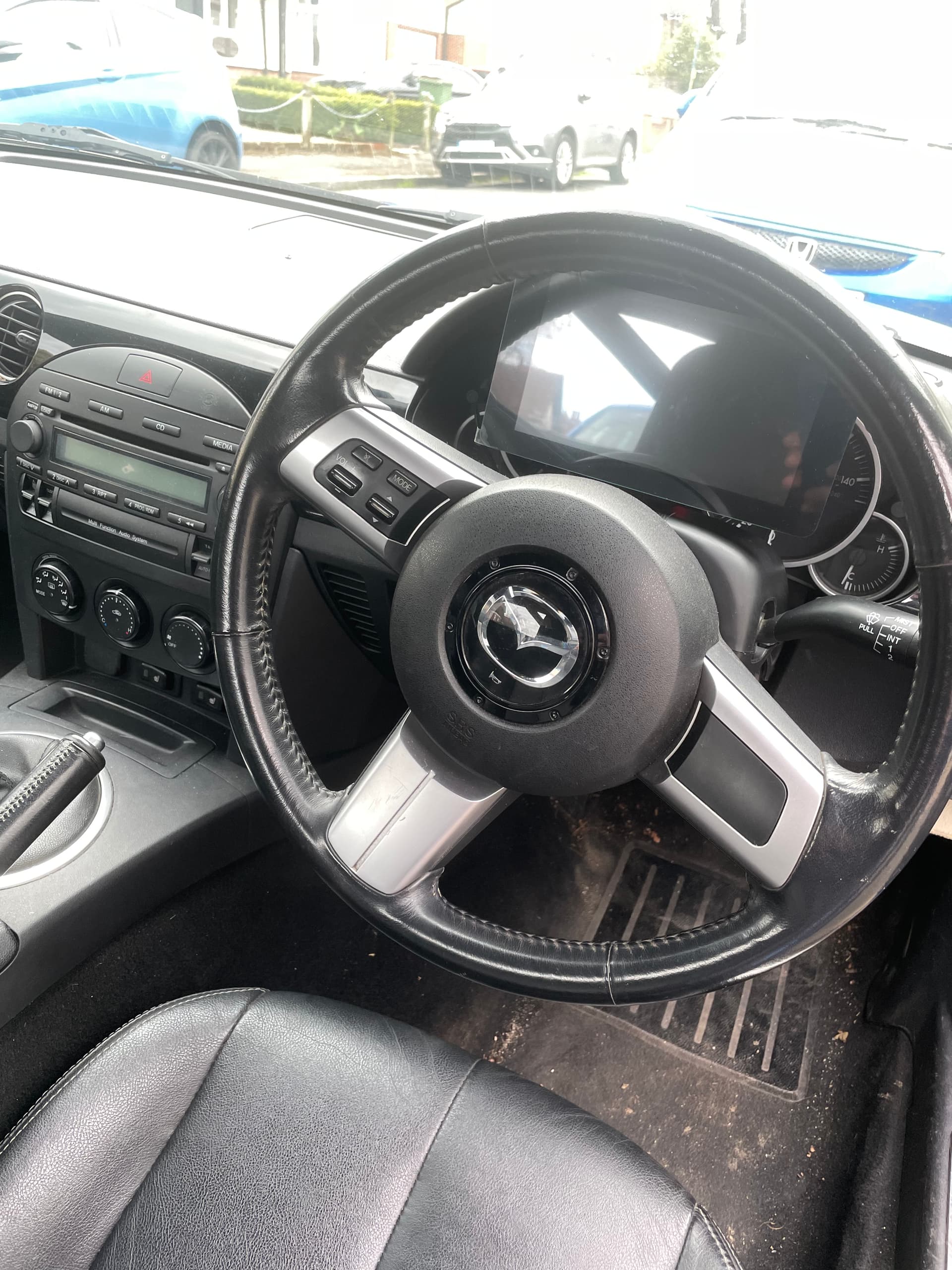

Took a while sorting out the mounting of the Powertune Digitaldash as the face of the screen cannot be further forward than the leading edge of the top steering column cover or it fowls when you turn the wheel, so I moved it back, then back again.

The screen is bigger then I expected seen some expensive ones that are quite small.
