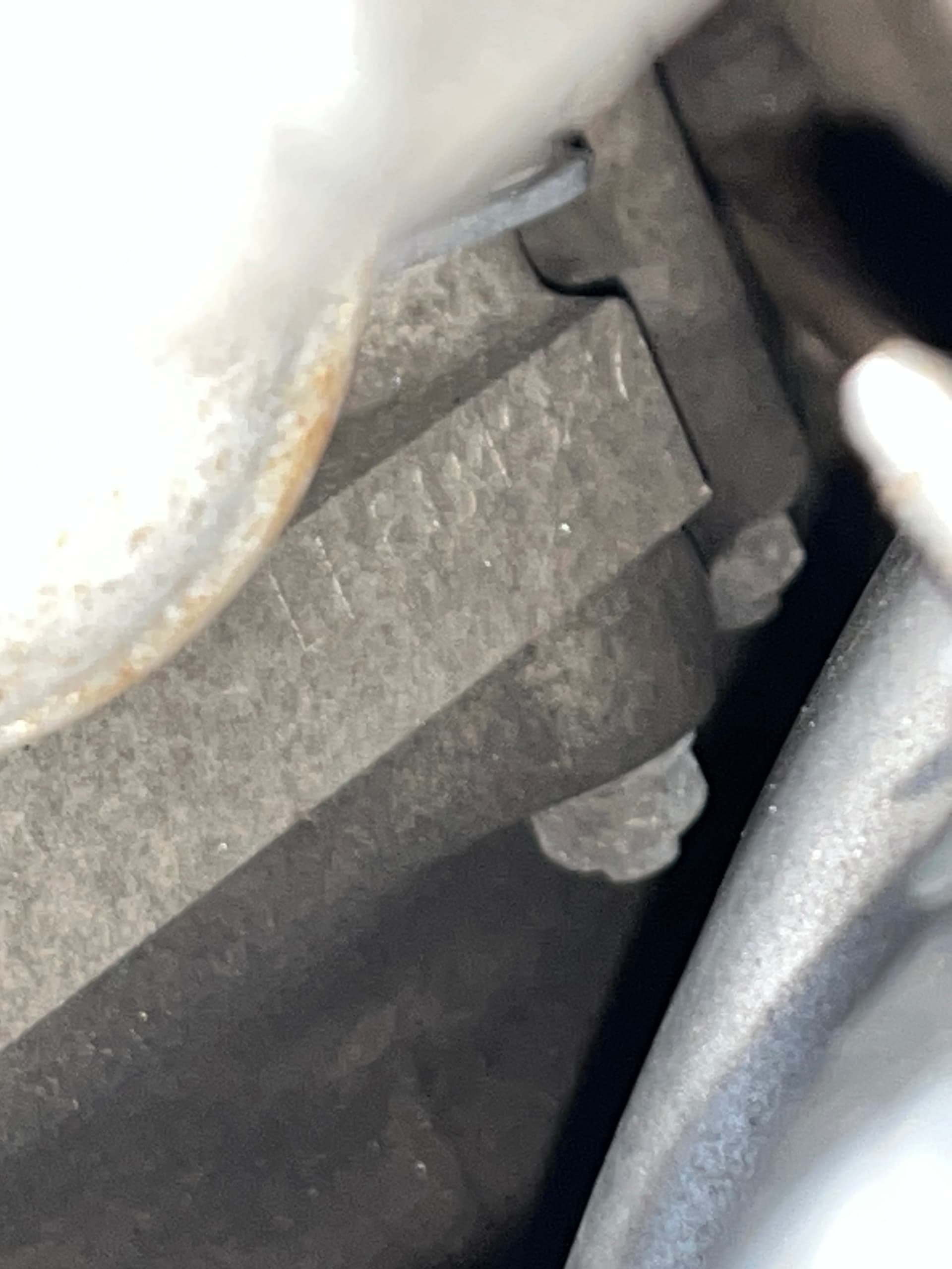

Oh dear well I checked my Irish tax book for an engine number to see 111734 but to find the block saying LF834…. Seems like the impact trashed the original engine. Is there any chance I have the NC2 forged engine with the number starting with ‘8’ ?
No idea to be honest I have not found any ‘engine number decoding’ info myself.
My engine starts with LF1 so I am pretty sure it’s an NC1 block but would be nice to know when it was done.

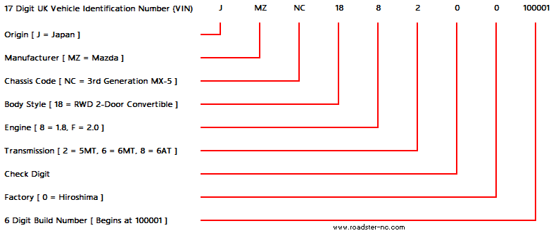

I would like to know too but unless you can guess the whole vin not much you do. Unless you call mazda homologation but you may have to pay for that info. You can almost guess the vin tbh. if the car was a 6 speed manual made in japan it should start with JMZNC18F6 i think.
