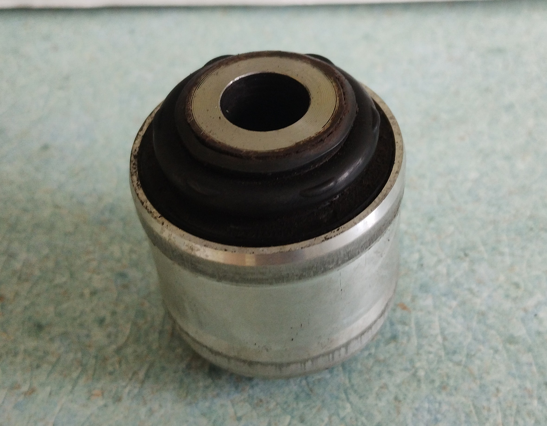

Are my original bushes goosed, I can’t tell they have a good deal of movement in them (so have the new ones) and I can’t see any splits or perishing. Time will tell of course but at over 10 years old it seemed a worthwhile job to tackle.
These are all the old original bushes.
When I replaced the bushes on my car the original top bushes were less worn than the bottom ones. However it would have been foolish to just replace the bottom ones whilst the car is apart and the old top ones could well wear more rapidly when new bottom ones have been fitted.

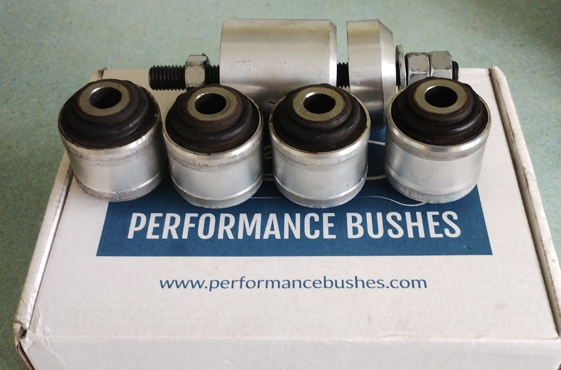

Just to provide a little more info on the Performance Bushes kit….
A short test drive the other day after fitting wasn’t really enough to tell if they have fixed the problem. I had rattling from the rear when going over rutted road surfaces. Whether the boot was full or empty it didn’t matter as I thought it was related to being light on the rear end.
Well new bushes fitted we went on a trip up to the Peak District today, gave it a good workout. It’s like driving a different car, a new car even, so smooth over the rougher roads, no knocking or rattles from the rear, success :+1:
