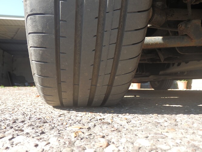

Anyone else suffered from perishing / dilapidating Goodyear Eagle F1 Asymmetric 5s?
Mine showed perishing 360deg around all 4 tyres after just 18 months (6,200 miles) ! No racing and no track days etc. Just normal driving varied roads Mway, A and B roads …
They were date stamped 2119, fitted new Sept 2019 and MOT advisory March 2021 ! Replaced in Sept 2021 due to progressive dilapidation and outright fear of an accident, now replaced with Mich’ PS4s (which are wonderful tyres !).
I am OCD about keeping the tyre pressures at 29psi at all times.
Tyres were 205/45R17 88Y Extra load.

Cracking around the side area where the tread starts does not seem that surprising since this area apparently takes the squashing rotation and flexing and side movement forces and over time small fissures appear as the rubber takes the forces and slowly deteriorates with age (especially on older tyres nearer 5 yrs old). My MOT guy was not too fussed about those unless they progress (I have a CX5 with Toyo tyres with those fissures, nothing progressive and MOT is OK with it but will need replacing soon as they are coming to 5yrs old). BUT open cracks within the grooves 360deg around 4 tyres that progress and could eventually expose steel cords is absolutely a different and dangerous ball game !

The tread rubber in that base area is very thin and tears easily, under the right conditions because it is a less flexible rubber than the capping layer underneath.
It is far more common than you think.
Underneath the tread is a capping layer of rubber and the fabric belts before the steel ones.
There was very little danger of the core becoming exposed. I doubt the manufacturers would view it as a form of serious defect.
