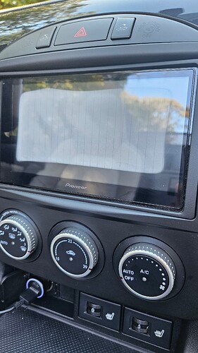

After sitting in some traffic today for approximately 10 minutes, with the roof down and the sun directly behind me, my screen has done this. It’s gradually receding away so hoping it self resolves.
Just posting wondering if anyone else has experienced anything similar and as a warning to all. Bit peeved tbh.
Had a small patch on mine a couple of weeks ago, also a Pioneer.
The cold morning (roof down) then the sun on the screen from behind made like a hot spot on the cold screen hence condensation. Not happened again and been out in similar conditions since.:+1:
It’s nearly gone now thankfully. Was a bit worried there may be ambient moisture in the cabin but it’s definitely dry as a bone in there, so as you say must’ve been a combination of cold screen, cold moist air and dazzling bright direct sunlight. Fingers crossed it doesn’t happen again.

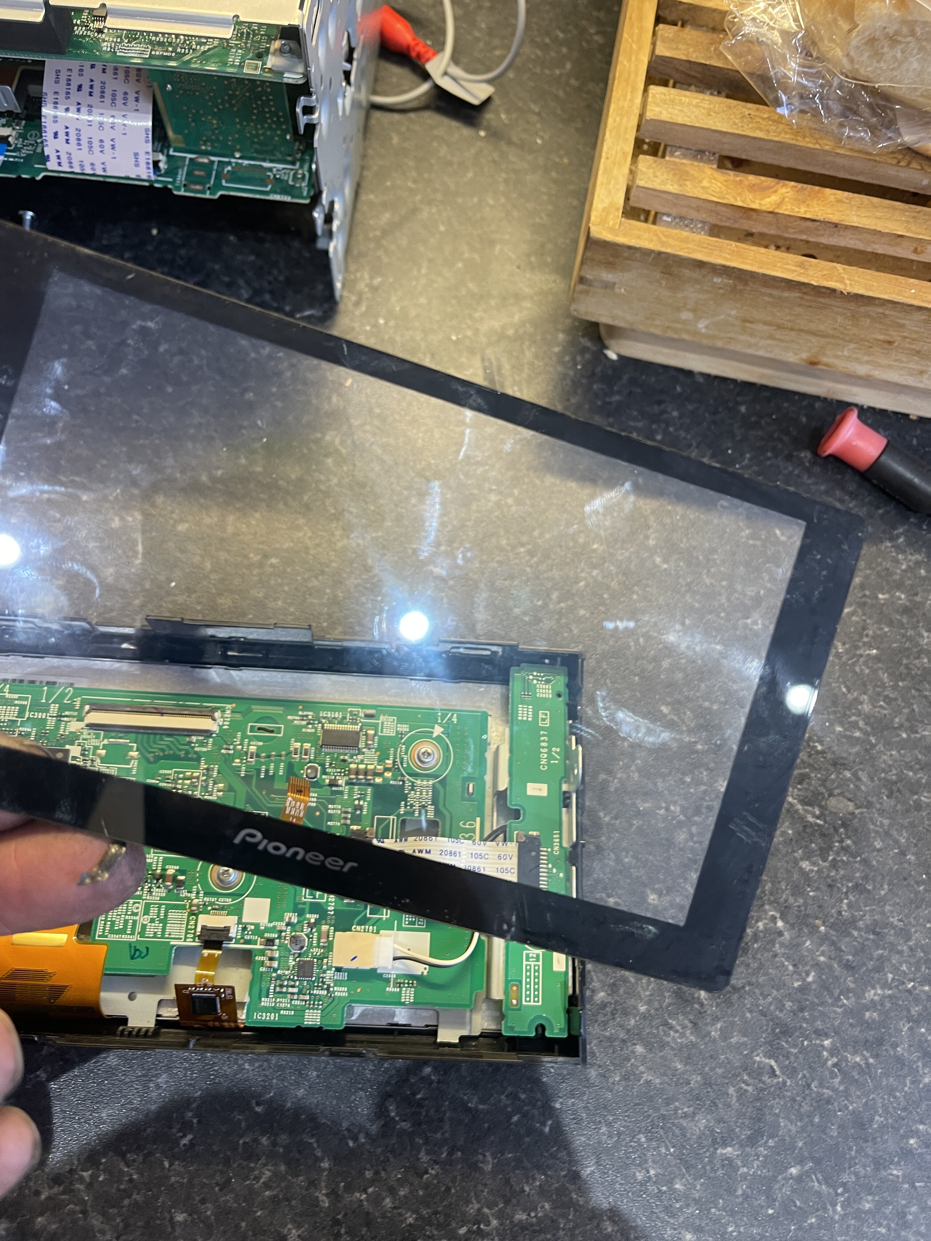

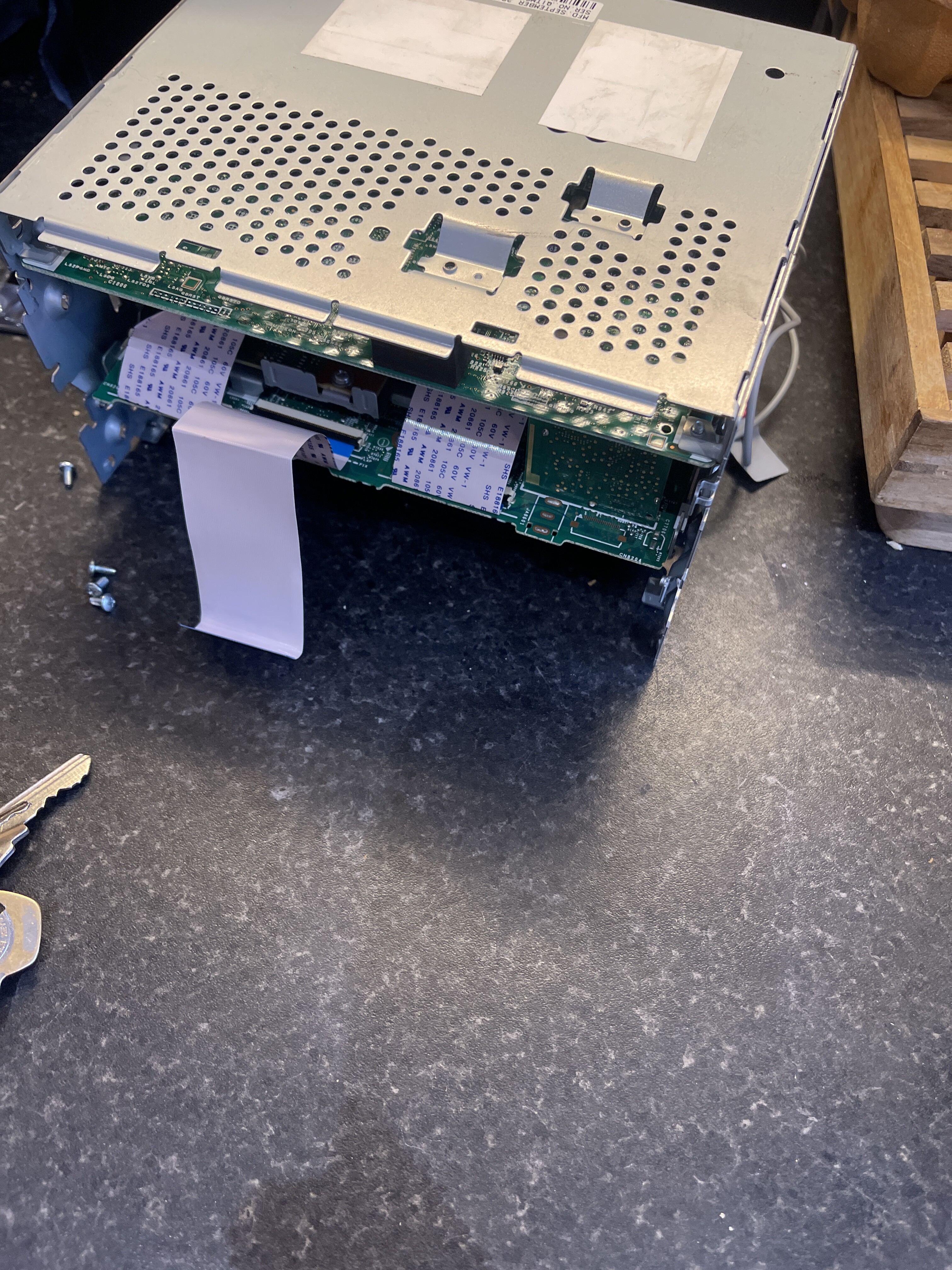

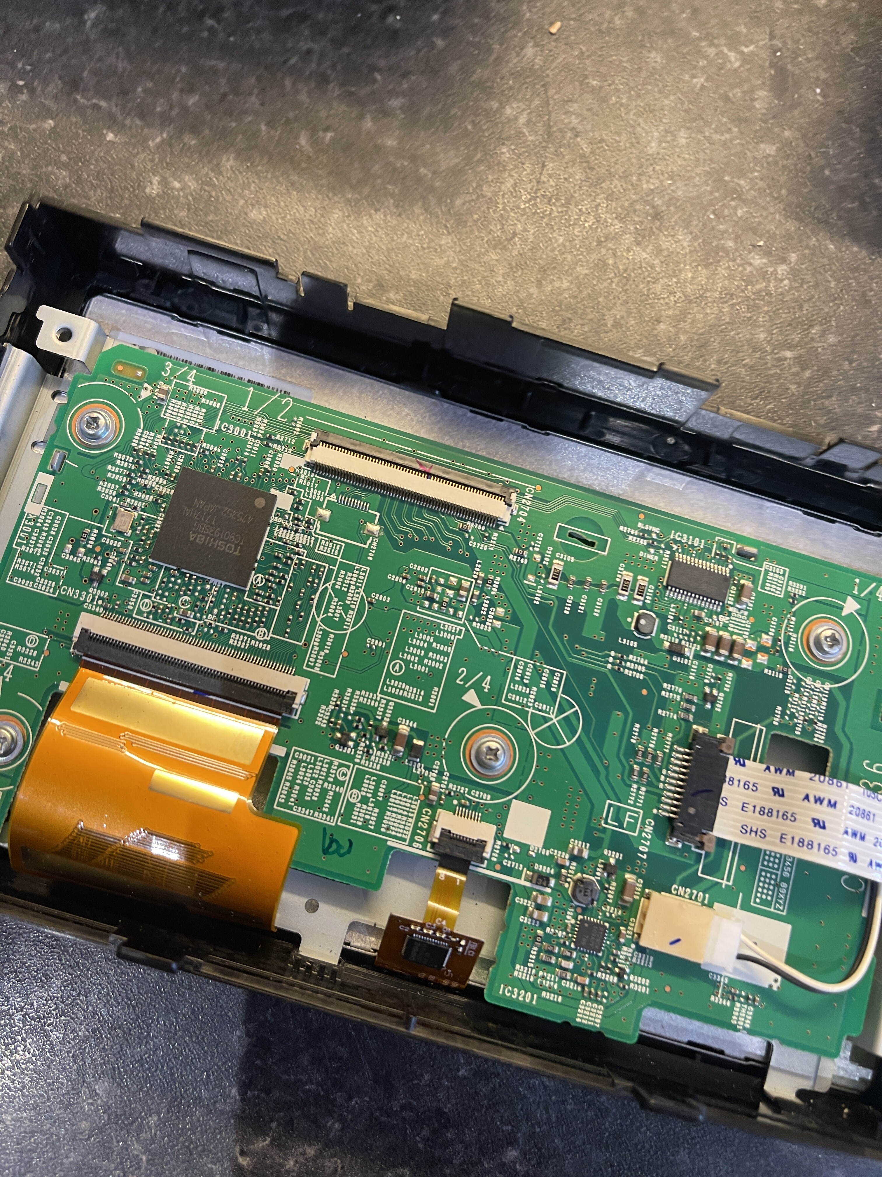

I had a patch on mine after the sun was on it wouldnt go away bought a screen off ebay and replaced it not to hard a job

If your not to far away and wish to buy a screen I could always fix it for you it only takes half hour or so Think i paid 40 quid for a screen

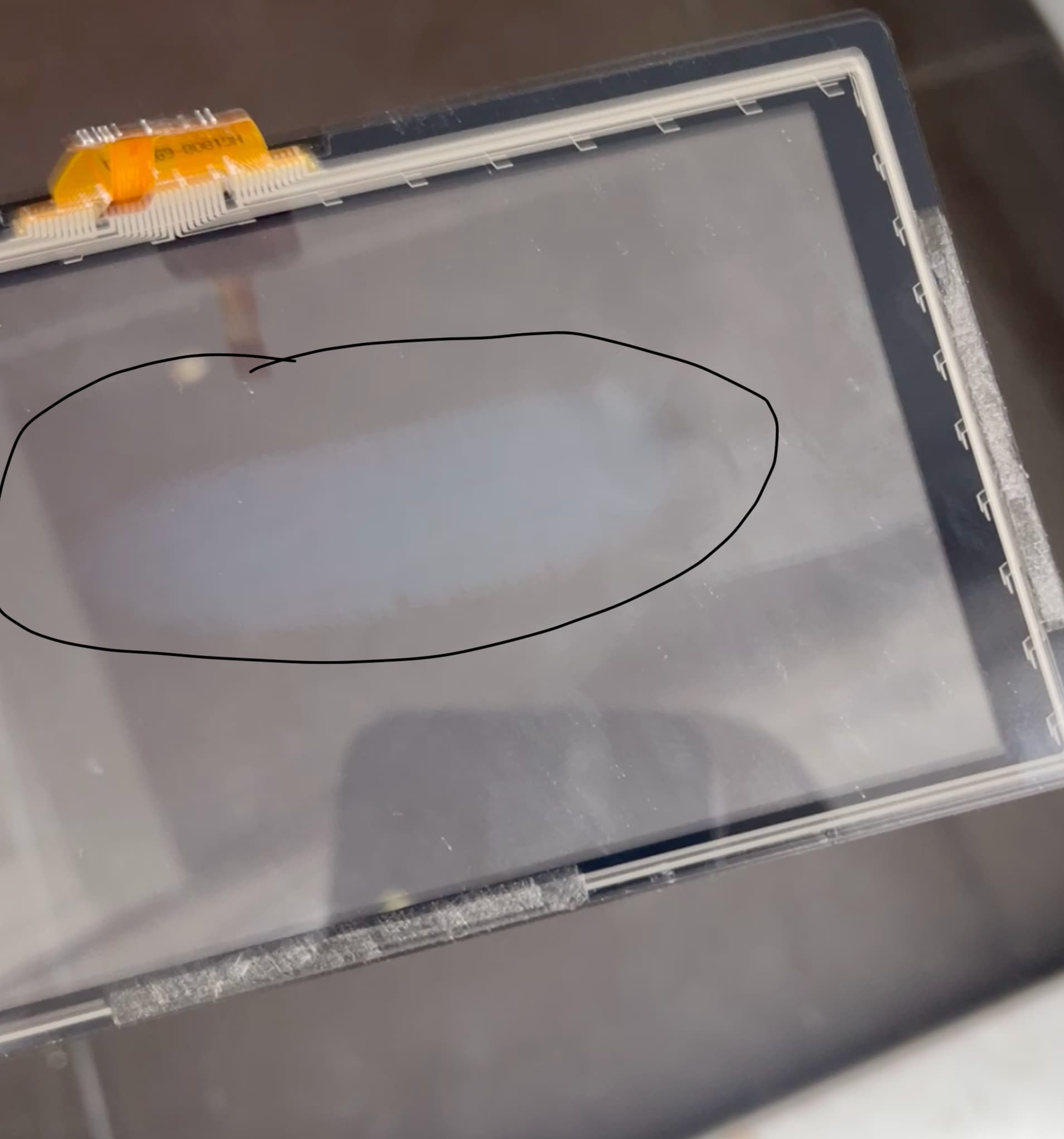

even when you remove the screen you can’t wipe it away its between the glass and the touch sensor thats bonded together
