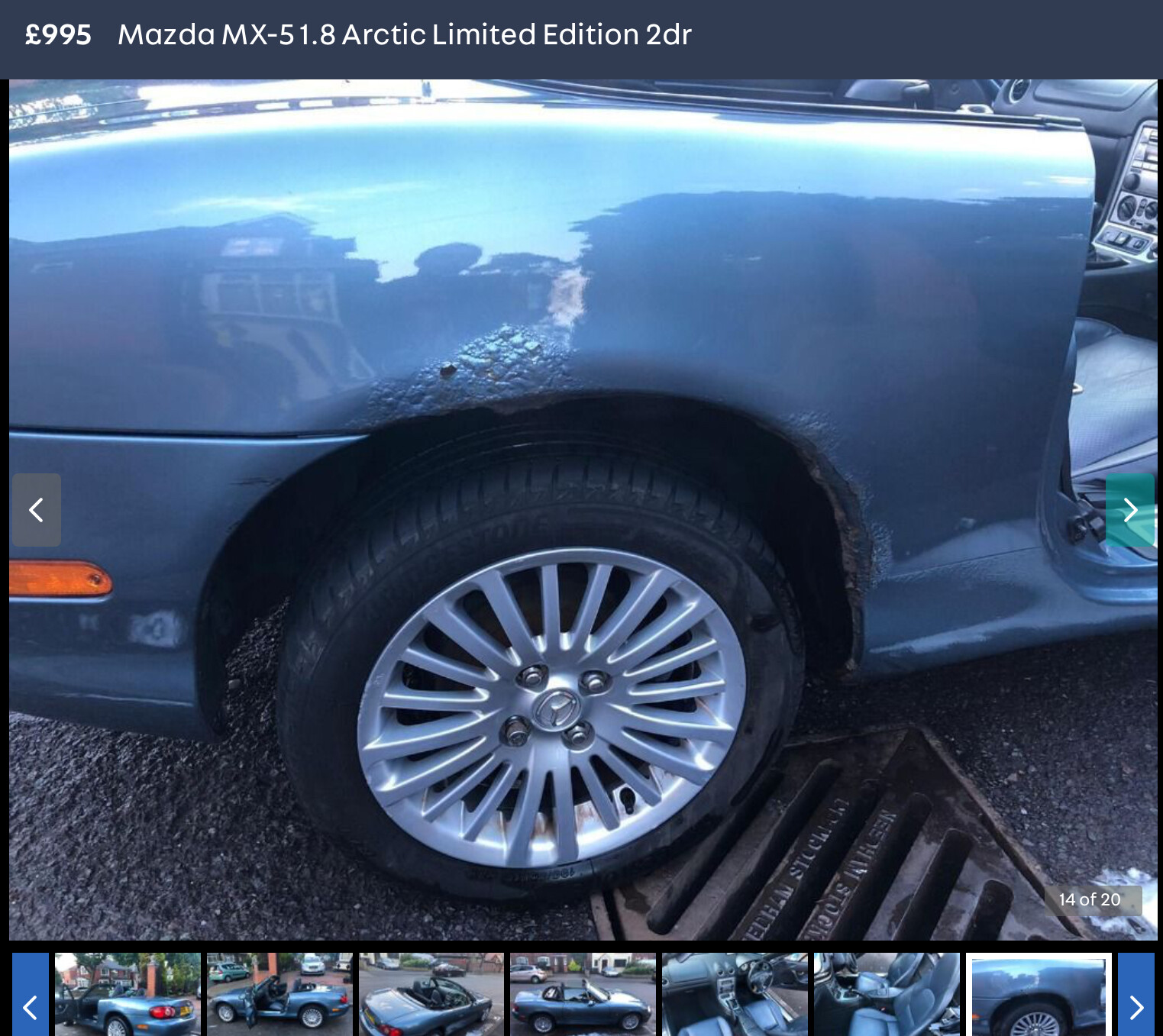

Assume this is the very bubbled arch.
If the front legs have rusted (probably); £500-1000 in repairs. If the sills/rear arches have gone; £600-700 per side. One is already rotted, the other one will be as well, or not far behind. I would make the assumption these will need doing now or very soon, so you can focus on things that get often overlooked; is there crash damage (these are sports cars, and sports cars do get crashed), roof condition (£500-600 to replace), engine mechanicals (140k; the engine should be ok, but the rings can stick on the 1.8), clutch (£250-300 to replace; if its not been replaced, 140k miles is getting to the end, suspension (springs often crack; does the MOT history have a history of spring replacements, which might indicate that in general, the suspension is getting tired (£500+ to replace), handbrake efficiency (an issue on all NA/NBs, due to the Lockheed Girling caliper design, caliper is ~£200 fitted a side with all hardware);, trim; is it all good (torn leather seats can get pricey to fix).

Drivers side arch, sill completely gone, £600+ to repair. Had a scrape at the front, so another £200 to repaint the front bumper. Interior in good order, minor wear to drivers seat. MOT history indicates “surface corrosion” on both rear sills; its never surface corrosion, so both sills have rotted, but one might be put off for a while. Also underside is generally rusty; I can imagine what this will be like; one older MOT indicates “heavy corrosion” (underseal has been slapped over it; ask who did this). Strong likelyhood that the front chassis legs are starting to bloom.

Expect corrosion under the car as well as what you can see. As I see it run it with the MOT for a year and expect to spend twice as much as you paid bringing it back to a decent car, rotten parts dealt with. It’s certainly only had the money spent on it to gain an MOT each year, mechanicals maybe looked after better than the rest.

Well, there could be easily £2-2500 to sink into that car , probably over the next couple of years. The question though is can you up your budget from £1000 to £3500 to avoid having to do that work (and no guarantee that you won’t have to).
