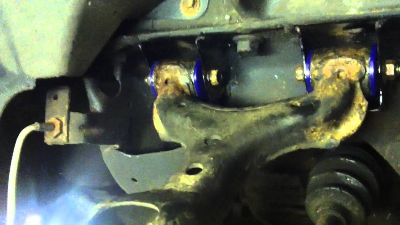

As far as I know, ALL poly that isn’t Superpro should be avoided like the plague. There is a video demonstrating why the non-SP ones are pretty much universally bad as they’re nearly all like this as far as I know:
The design of most of them don’t use a proper “squishy” material, they don’t fit the same as the OEM ones, they stick out too far and they don’t hold any grease. It’s common to see the suspension arms stick like this within weeks of installing the “cheap” ones. I think the full Superpro kit for our cars is ~£600 in some places, with the very cheapest full kits being about £400? SO not worth it to go back in there again, and why compromise here of all places?
