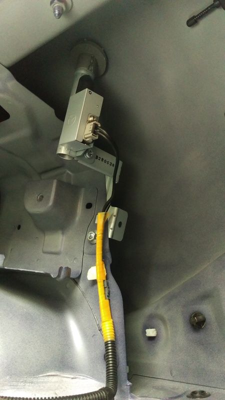

The NC also has an rf amplifier sitting on the bottom of the aerial.  If this is missing its power (blue wire, enabled when the radio is switched on) or a proper ground wire (black or a braid strap or a bolt to the bodywork) then this can also be the problem as well as the damaged or loose co-ax.

If it’s the AVN2 unit that you have, I’ve seen one before where the aerial amplifier wasn’t wired correctly from new, giving similar symptoms to those you are describin. The wire was in the wrong position in the patch lead between the head unit and the vehicle wiring harness.

Yes, from memory there is a blue wire in one of the block connectors with nothing connected to it. I’d take it to a dealership if it’s still in warranty.

So, I’ve stripped out the boot linings and taken a pic at that end
I cant see a blue power cable to the amplifier…

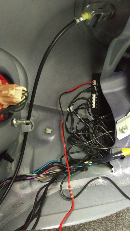

On a separate note, I’ve been trying to resolve why the rear parking sensors aren’t working either!  Having got the rear boot liners out, I’ve visually checked the box, sounder and cables between and can’t see a problem.  I’ve also checked that there is power to the reverse light and that seems okay?  If anyone has thoughts on that, gratefully received!

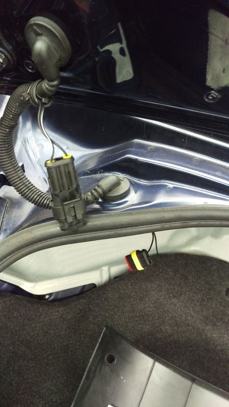

I also have a slightly confusing cable next to the boot lid hinge on the kerb side:
there is a sort of blanking piece inserted into the end of the piece hanging of the boot lid, and this corresponds with the male end hanging in teh boot (red and yellow in the pic).  It seems odd as the bit hanging off the boot lid looks like it will get trapped in the boot rubber sometimes.
any ideas what these are for? Thanks!
H’mm - looks like a DIY project gone wrong to me, some of that wiring looks additional to OEM, I’d describe it as an unholy mess. Definitely beyond your scope I’m afraid, take it to the dealer, or a good local auto electrical mechanic. With no drawings, it will take some time to figure it out, unless Robbie recognizes the wiring as standard, and can supply an answer.

the parking sensor wiring does make sense to me - a live fed from the reversing light, with earth to body, then a cable connecting the controller to the sounder, and finally four connections between the sensors and the controller. Looks messy because whoever fitted it has bundled up the excess cable from the sensors.  Why it doesn’t work, however…!?

However, another thing - that photo inside the boot lid, and the socket hanging down with what looks like a dummy plug stuck in it - There’s what appears to be a grey and grey/white wire leading to it, any sign of the other end of these wires in the boot? Or - do they lead back into the car body? - If no sign of them in the boot, then they must be from inside the car.It looks like someone pulled the cover back, yanked out these two wires (with or without the plug?) so they could access them at this point - not the best way to do it I would add.
That’s strange, because the red/yellow plug hanging down also seems to be leading from inside the car, so what’s that all about? (Not asking you - just thinking out loud!)
I get the impression these two should be together - plugged into each other, but they are also too short, to allow the boot lid to open to it’s full extent, so have they come apart, or been left that way for some unknown reason? A dummy plug (or socket) plugged in would - to me - indicate a live circuit, but that’s just my impression, who knows why?
For safety reasons, a manufacturer will always connect a live feed to a socket, and the dead circuit that follows into a matching plug, so which is which in the photo?
