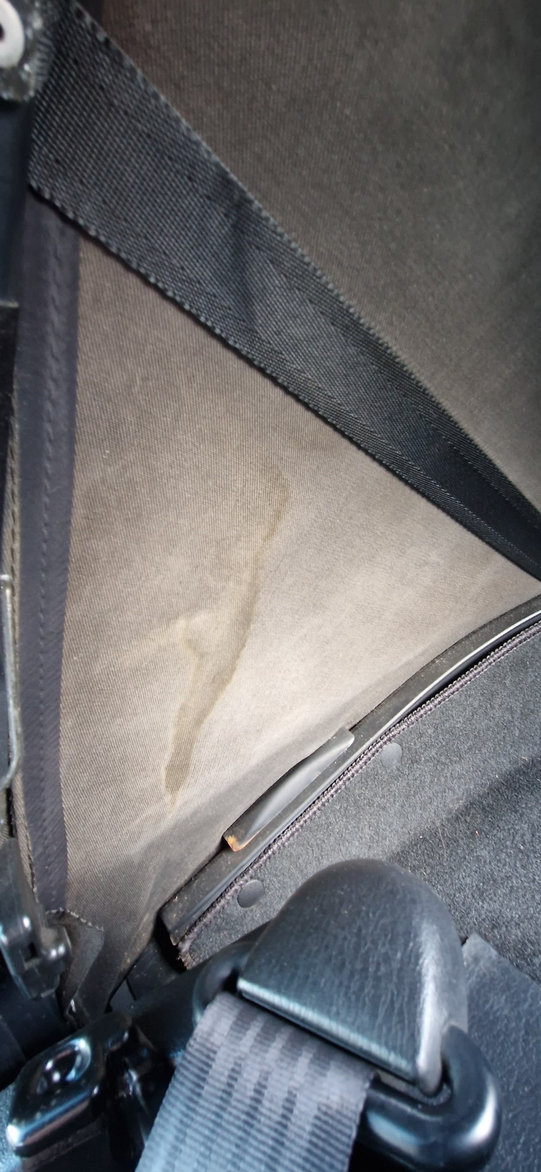

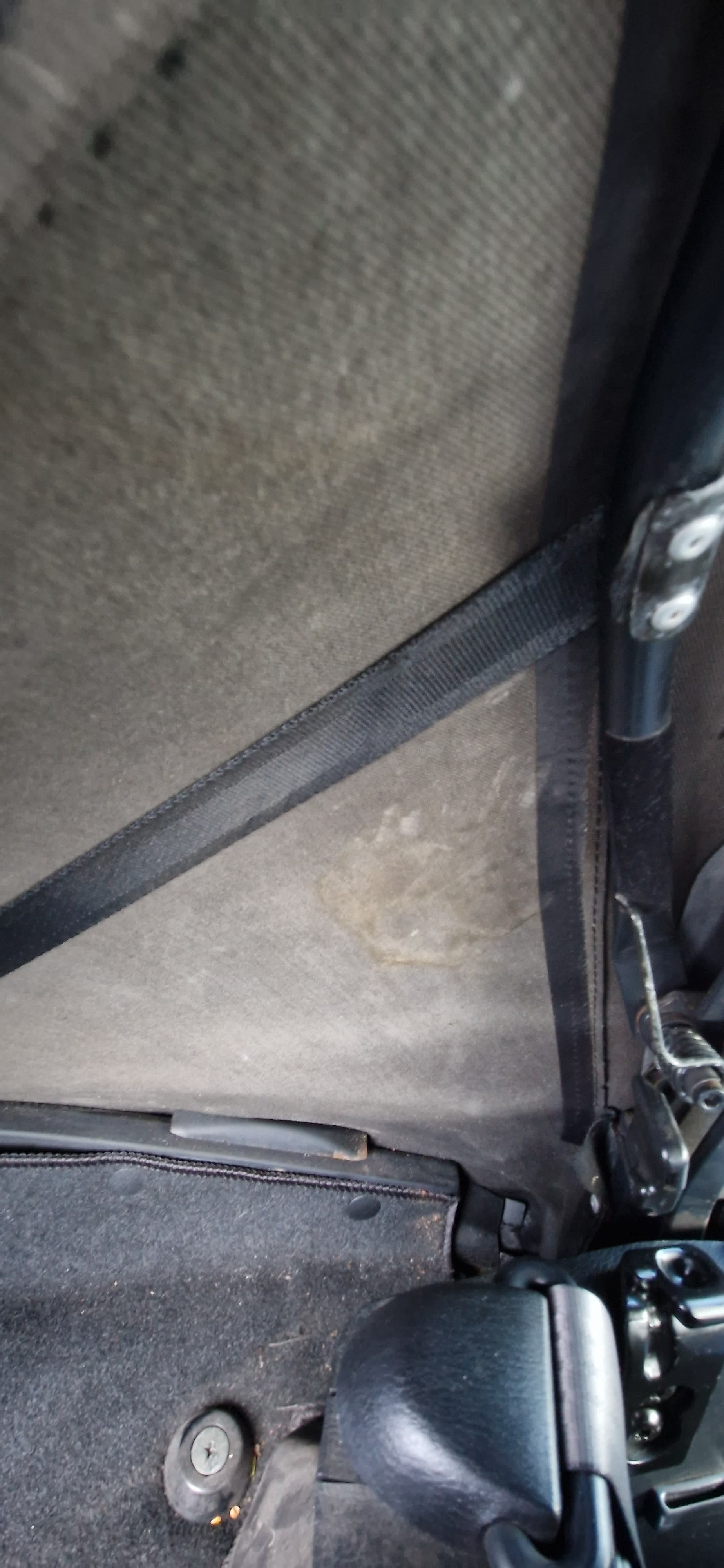

Can anyone tell me what the white marks are in the attached photos please? I think it’s some sort of water damage. Any advice on how to remove them ?
Thanks
Dried moisture marks/condensation.
The outer skin needs re proofing, you can clean the inner skin with Bio wipes, and re dyed with the fabric re blacking dye if wished.
M-m
Cheers MM!!
Re-dye the inside but only waterproof the outside. For added protection should I proof the inside too or will this stop the moleskin from breathing?
Good clean on the outside and apply fabsil, no need to to apply on the inside.
M-m
Thanks so much!!
