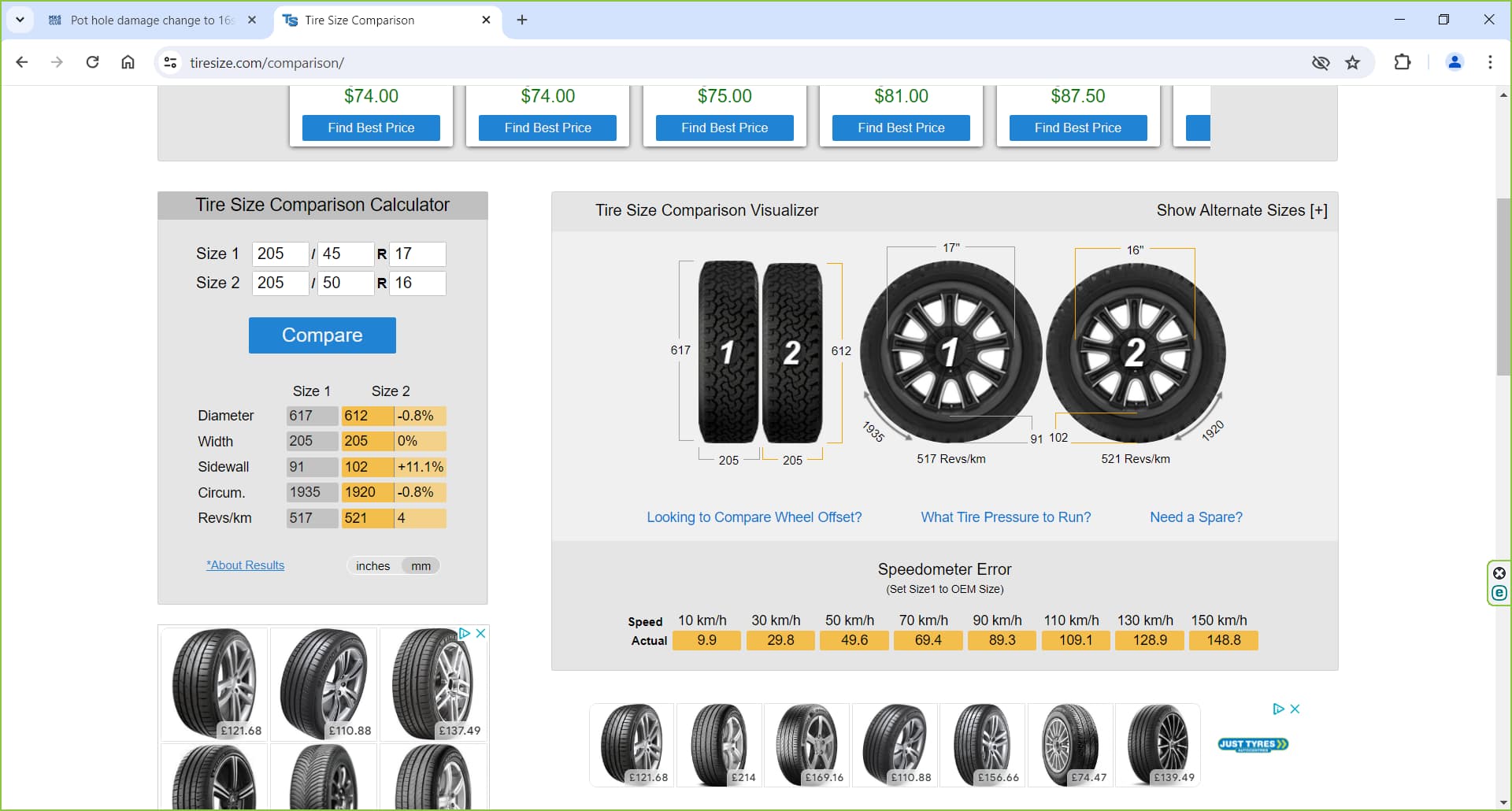

I’m looking at some 16x6.5 et 38 would these fit and what would be the best tyre size to go for?
Many thanks all
This would suggest 205/50R16 is very close to 205/45R17
