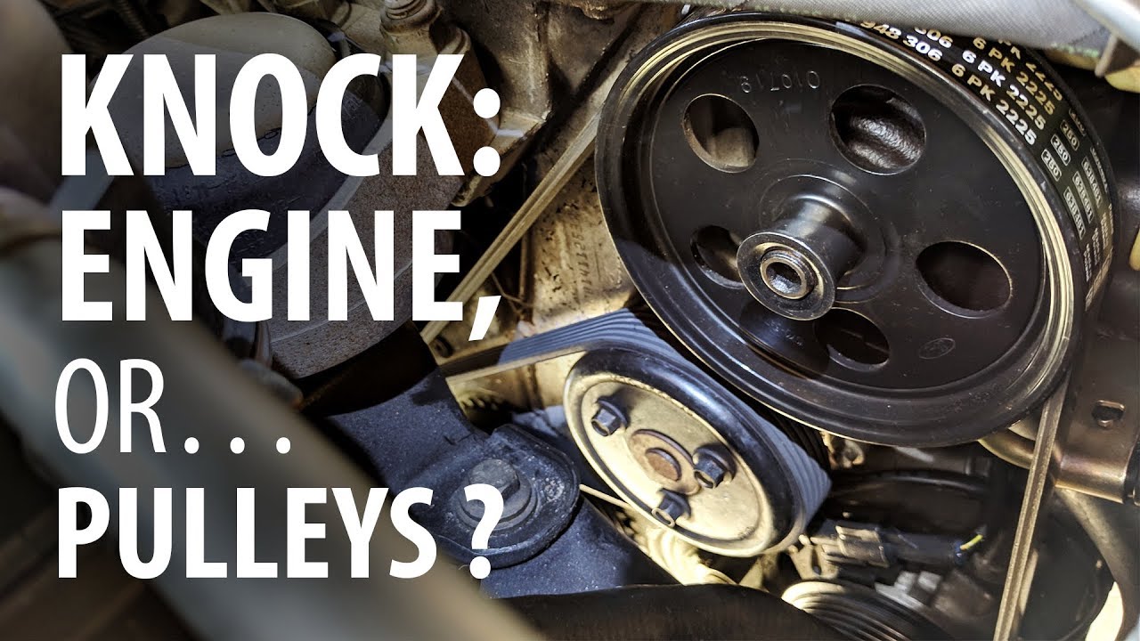

Just found this video which has the same rattle at about the 31 - 37 second mark, which was eventually solved by replacing the alternator pulley, the noise is the only time i’ve heard my exact noise outside of my car, just weird that it doesn’t go away completely with the belt off, it’s a massive headache
Now we get the video we wanted in the first place.
If it’s under warranty I don’t know why you’re paying the bill and it’s odd how it uses no oil.
It sound like bottom end knock to me, but I can’t commit as it’s not in front of me. Decent engine builders have an ear for it, which is why I suggested you go see one.
If it is it’ll knock very lightly (and undetected to the average Joe) on the over run. Shame you changed so many filters because the evidence will have been in there and still might be.
Engine failure is not always binary.
The only other way is to get someone to drop the sump, but before that cut the oil filter open for an inspection.
