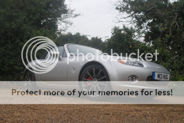

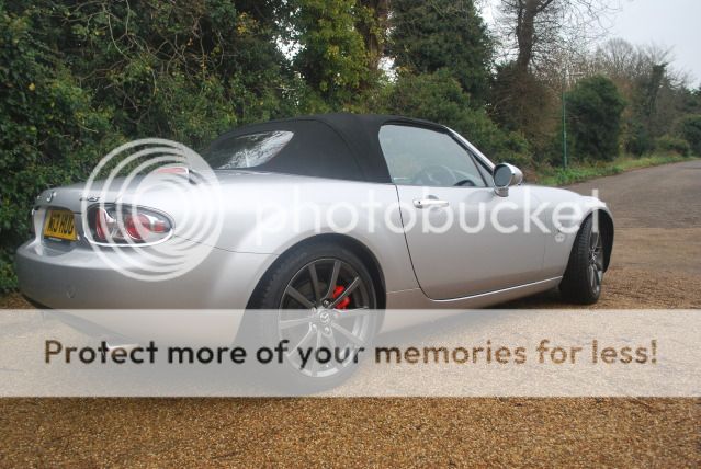

Our winter wheels have been powder coated in graphite…

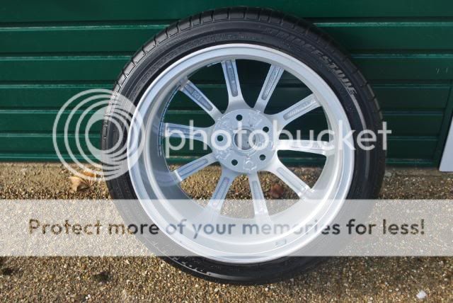

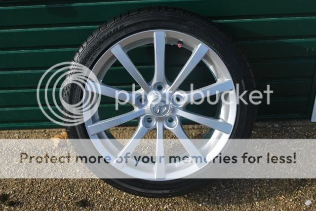

Also the original wheels have been powder coated in sparkly silver…
Absolutely no problems with either set of wheels which were refurbed/powder coated by local wheel refurb specialists.
