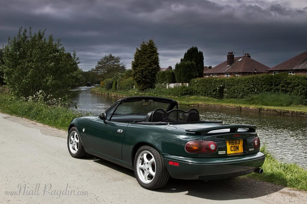

The wheels on my Mk1 are refurbished Mk2 alloys which have been powder coated and then lacquered. However, the mating face where the wheel meets the hub was not coated (or had been subsequently cleaned off - but I assume they just masked that area off) so the concerns that have been raised elsewhere don’t apply. I’m very happy with the finish, they are like new wheels.
No close-up pics of the wheels unfortunately but here’s a shot of the car with the wheels on it.
