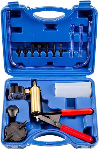

So I ended up buying one of these:
Total waste of time. Could not get an air tight seal around the nipple so every time I created a vacuum, air was drawn in to the pipe so no way of telling if the air was in the the brake lines of coming in through the side of the nipple.
My mate was helping with fitting the new hoses so ended up just bleeding them using the brake peddle which was much more effective.
Conclusion: Stick with the old tried and tested way. Needs 2 people but guaranteed results :slight_smile:
