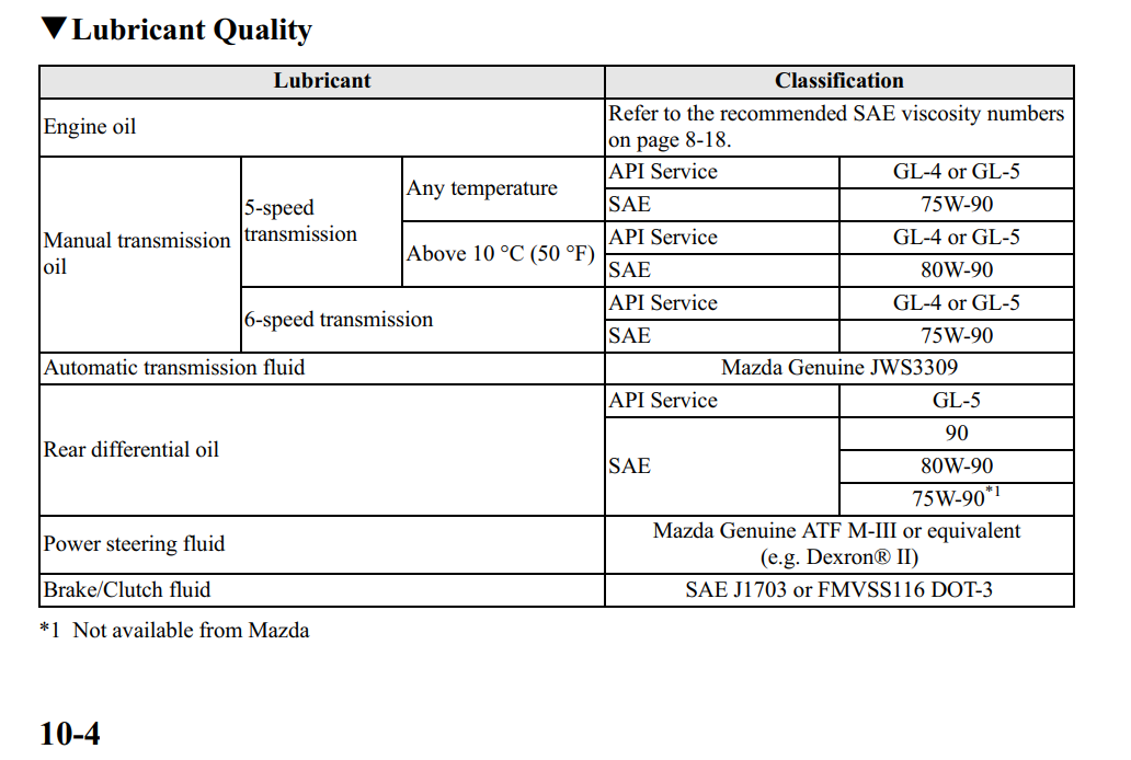

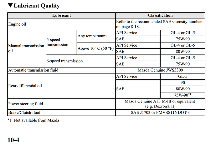

As per the manual:
Mazda Genuine ATF M-III or equivalent
(e.g. Dexron® II)
