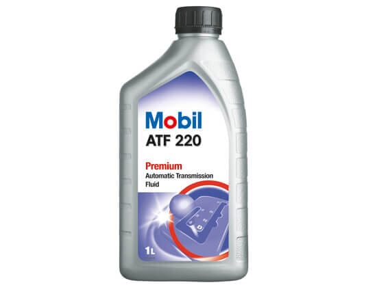

Same as autotrans ATF . No need to talk “grades”.
Any atf will do although there are specific PS fluids available from the likes of Halfords and others. Also buy a cheap turkey baster to remove as much of the old fluid as possible before you put any new stuff in. Let it run for a while and repeat. You’ll never get all the old fluid out unless you strip the whole system down but at least you can get most of it out this way, unless anyone has a better method?

Sorry to re-animate this topic but …..i’m very confused as many talk about ATF transmission fluid in general while i read scary story’s about leaking when not using proper power-steering fluid….Others say any Dexron II or III will do. I’m losing it realy so much contradictory info anywhere…..Don’t want to end up with leaks etc. Off course this forum is filled with knowleadgeble fivers so ; is it safe to use ANY ATF fluid? Or better stick to Dexron II or III or simply order/buy from Mazda and pay way to much….?
The second post down gives you the answer, I would choose that.:+1:
