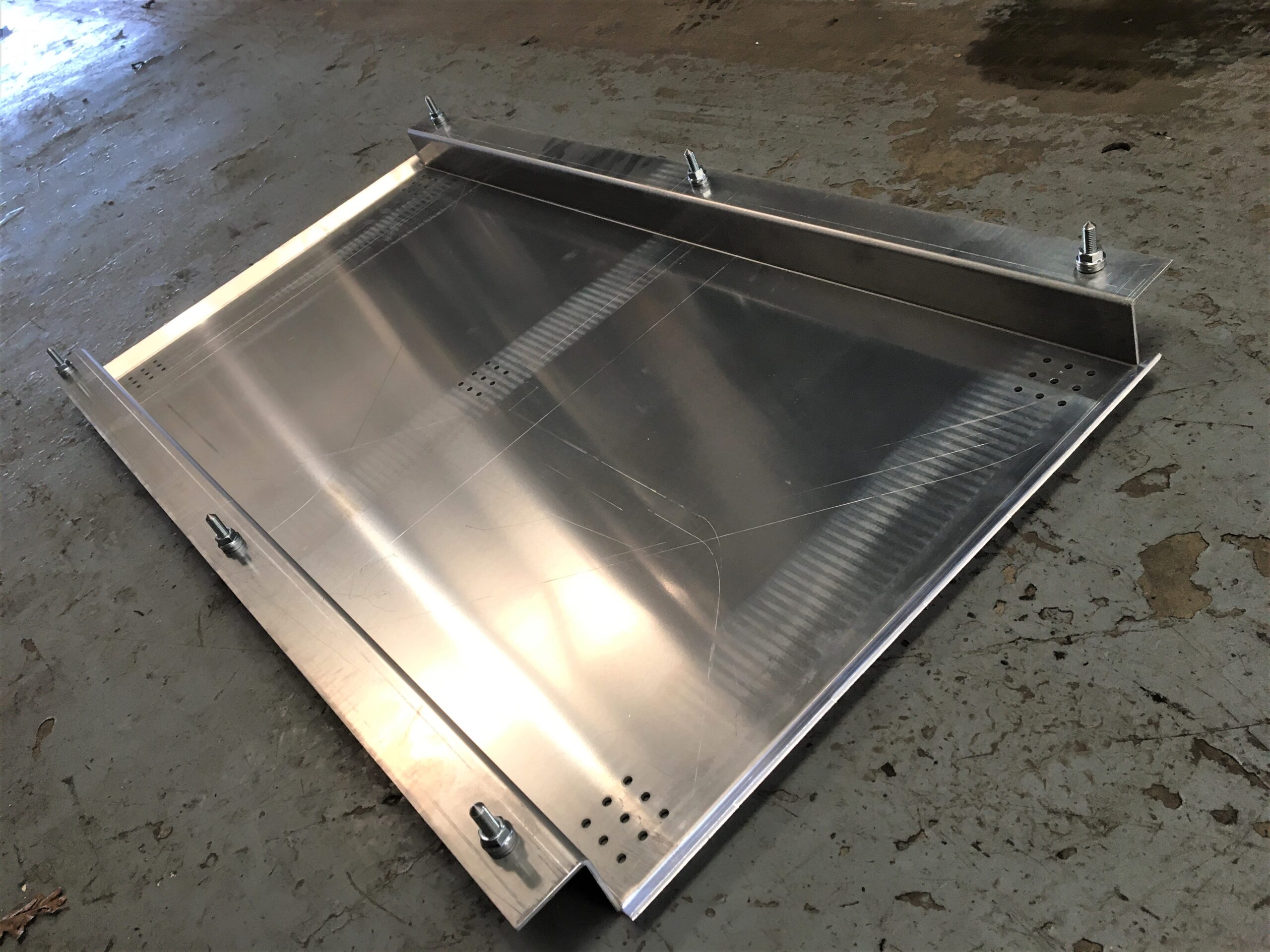

You could fit a plate underneath if you really want to. I think mx5 restorer do one, and there’s another company who does it as well
I’ll investigate the plate option, but without knowing exactly what is done, a plate fitted will be designed to be removed, but possibly with difficulty. So might just generate more damage, if the cat is stolen.
If you go on mx5 restorer website, product page they have a video about what it is and how it fits.
Like anything its a deterrent and making it too much hassle to go through it. I think the plate is also aluminium and that also clogs the tools they use.
There i googled it for you
