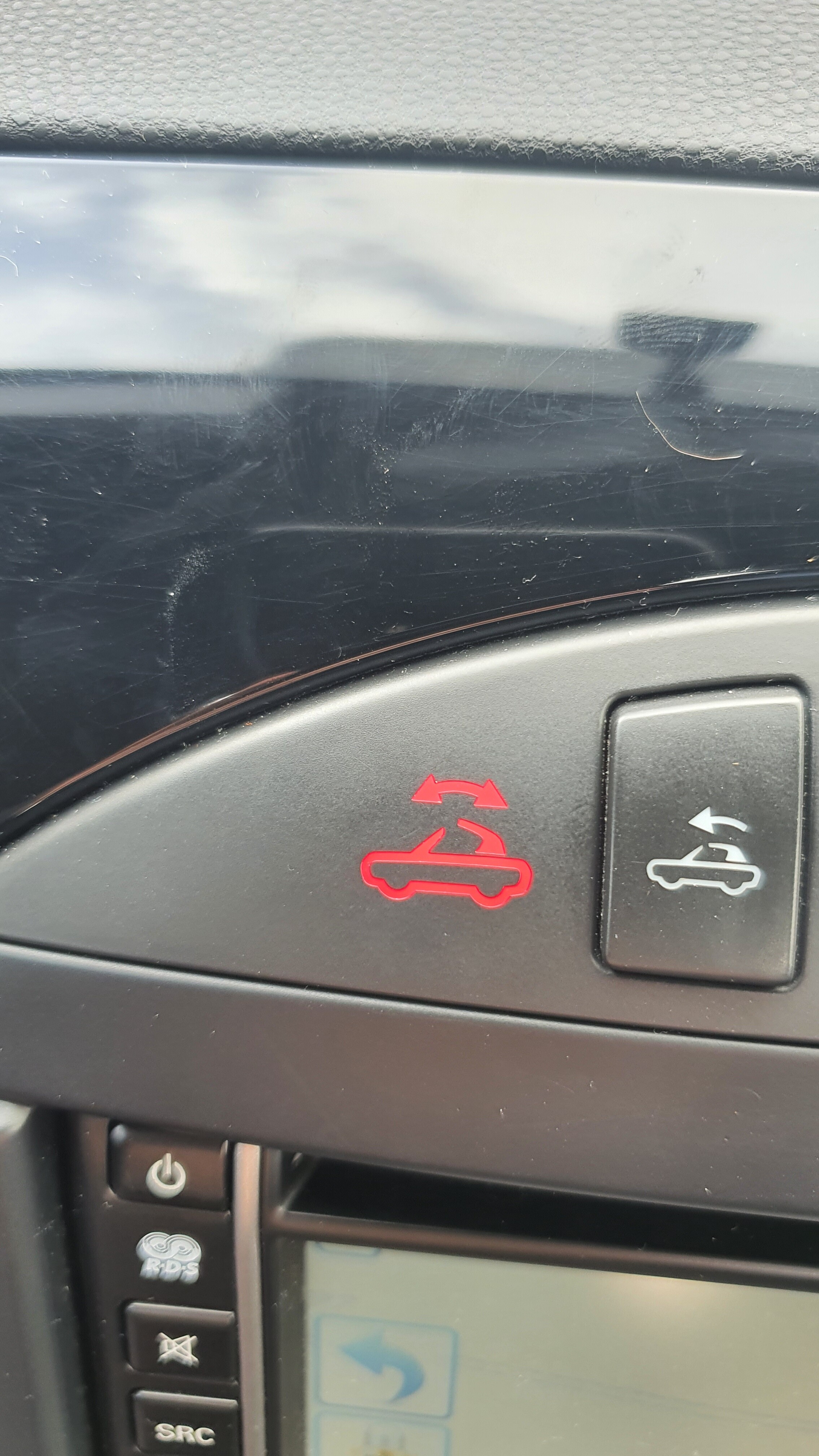

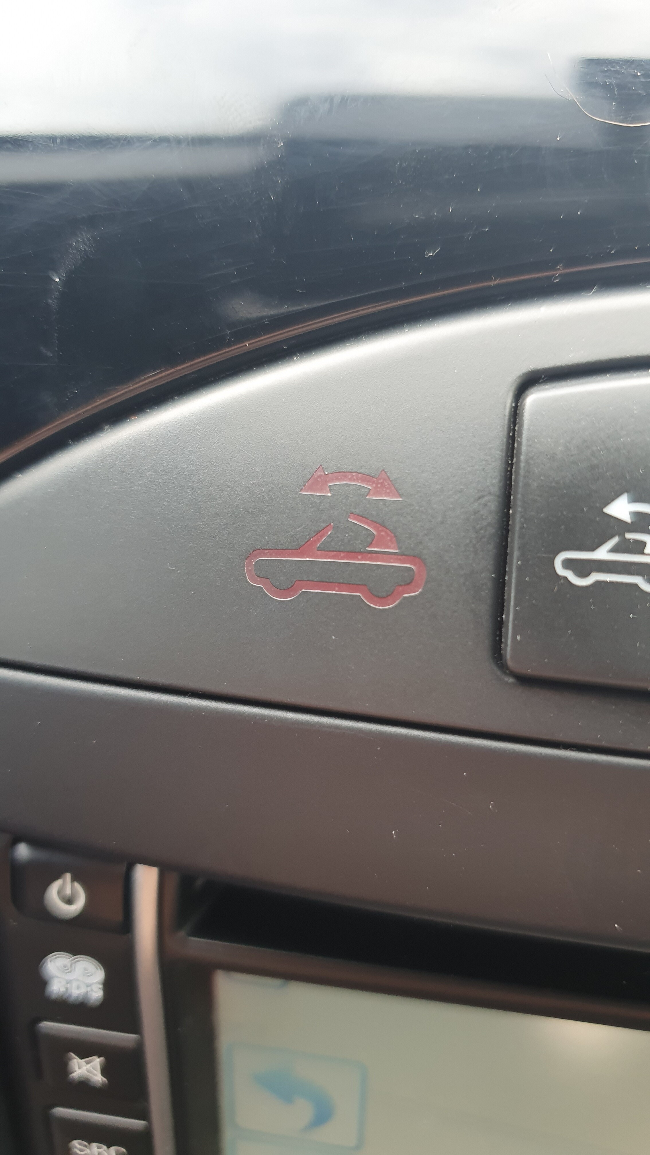

I’ve noticed the light does get brighter when I open the latch etc tried pushing the switch in with my finger and the light goes from bright to lower brightmess. When the car is at idle there is almost a flashing in the light where it somewhat flickers.
Here’s some photos to illustrate the difference hope yous can make it out

Have you sealed the scuttle panel grommet which the retaining screw goes into or sealed around the black oval cover plate on the top?
Until you have got the fusebox completely dried out I would not mess with anything else.
You may have either power or ground connecting to the light via an adjacent circuit in the fusebox.
Yes I sealed the grommet that the screw goes into and lo and behold after allowing everything to dry out well the light is now off. Just hope that it stays that way.
