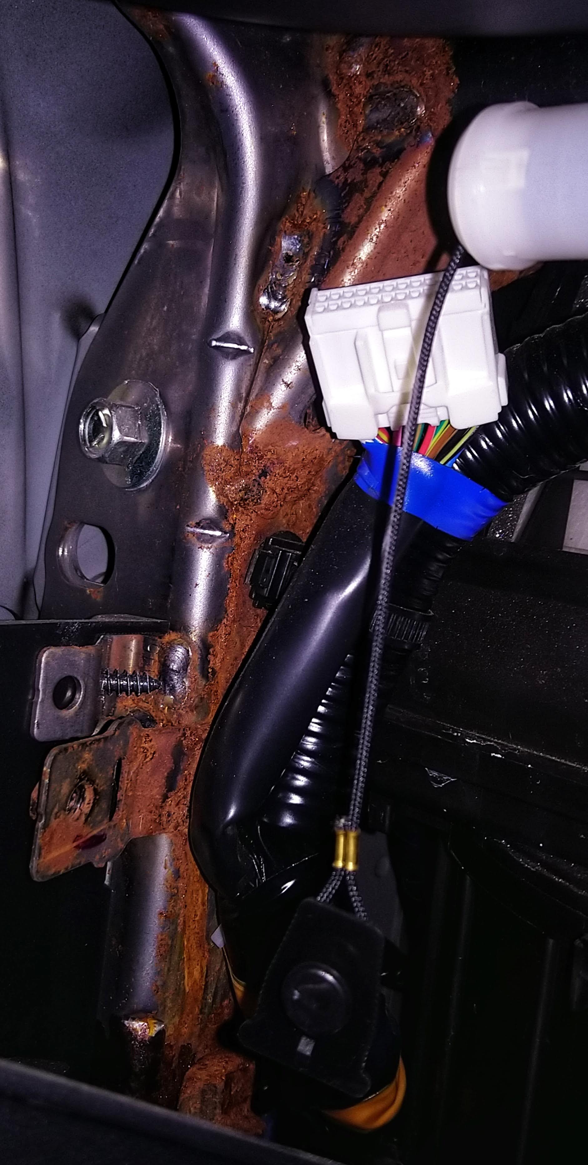

Only abated ???
I don’t want to say totally stopped yet. We haven’t had a dry day since I took it out if the garage and there is still a little (what looks like) condensation visible.
Whether this is just the last bits of water evaporating (couldn’t feel wet carpet but perhaps it was damp) or severely reduced leak i can’t say.
Main thing is the hard top has stopped showing off. Few hot dry days will show for sure.
This is how rusty ours got behind the glove box.
Presume that Mk4s don’t have this problem - they don’t have a glove box! :innocent:
They don’t have leaky grommets either…
