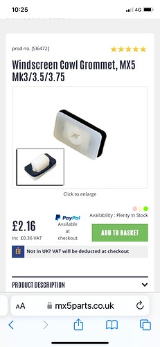

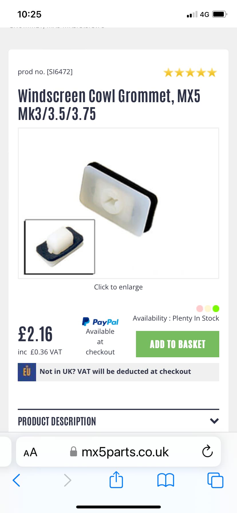

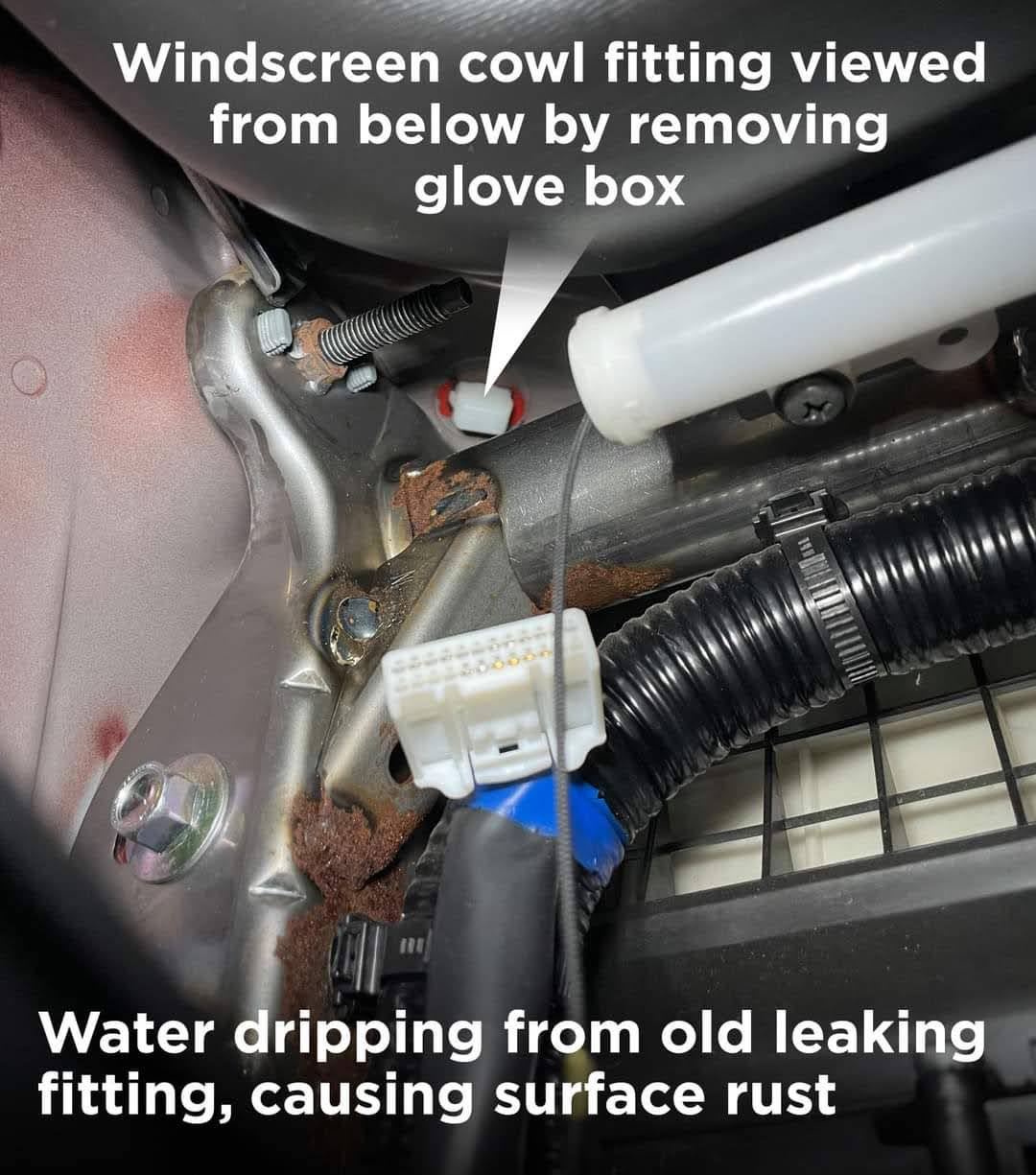

I know you said you’d had the windscreen cowl grommets sealed I would check them by opening your glove compartment and shine a torch to the back left hand side where the bodywork is exposed. This will probably be rusty and wet if the cowl grommet is still leaking. It’s a very common problem.
Like this (not my photo)
